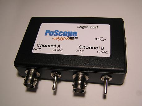

    Sprzedam oscyloskop, analizator stanow logicznych, i2c monit
    nowy nieuzywany
    2 kanałowy oscyloskop
    2 kanalowy analizator widma
    2 kanalowy rekorder
    16/8 kanalowy analizaor stanow logicznych
    8 kanalowy genertor stanow logicznych
    5 kanalowy PWM generator
    SPI sniffer / monitor
    I2C sniffer / monitor
    UART sniffer / monitor
    1wire sniffer / monitor
    TECHNICAL CHARACTERISTICS
    Oscilloscope, spectrum analyzer:
    - number of channels 2
    - sample rate 100 Hz … 200 KHz
    - memory depth
    buffer reading: 1126 sample/channel (1 channel), 563 sample/channel (2 channels)
    pipe reading: 64K sample/channel (1 or 2 channels)
    - input voltage -20 ... +20 V (hardware 2 sub-band)
    - ADC capacity 10 bits
    - triggering
    absolute (for rising/falling edge),
    differential (for difference between adjacent samples),
    external (for rising/falling edge of TTL levels)
    - window functions Hamming, Hanning, Blackman, Blackman-Harris
    Recorder:
    - sample rate 0.01 Hz … 200 KHz
    - maximum record time 24 hours at Fs < 100 Гц
    Logic analyzer:
    - number of channels 16 (8 if logical generator is on)
    - sample rate 1 KHz … 8 MHz
    - memory depth
    buffer reading (Fs=4-8 mHz): 128 bit/channel
    buffer reading (Fs=2-2.66 mHz): 1160 bit/channel
    buffer reading (Fs<=1 mHz): 1544 bit/channel
    buffer reading in concatenation mode: 1 Mbit/channel
    pipe reading (Fs < 500KHz): 4К to 256M bit/channel
    - input voltage 0 ... +5 V (available surge voltage protection)
    - triggering for edges, mask, miss pulses, external clocking
    - clocking internal / external
    Logical generator:
    - number of channels 8
    - sample rate 1 KHz … 1 MHz
    - memory depth 1544 bit/channel
    - output voltage "0" - 0 V, "1" - 3.3 V
    - maximum input/output current 10 mA
    kontakt konsolka(_at_)gmail.com
    gg: 1741384
    tel 694-447-535

    Jeszcze brak tylko ceny bo pasmo tego urządzonka nie jest za wesołe nawet do podstawowych zastosowań serwisowych.

    dili24:
    cienkie pasmo jest jedynie w oscyloskopie. ale to i tak 10 razy wiecej niz w porownywalnych ukladach.
    jako analizator albo sniffer urzadzenie dziala fantastycznie. mozliwoci ma full. podsluchac mozna praktycznie kazda transmisje
    recorder jako akwizytor 24h max to chyba niezle ...
    cena 400 zl

    Czy mozna monitorowac 16 linii na raz w funkcji analizatora stanow logicznych?
    albo np.15 i jedna do zalaczenia probkowania?
    Kable w komplecie do analizatora?
  • #11 3596024
    J_Bravo
    Posty: 1373
    Pomógł: 36
    Ocena: 161
    16 lini max na raz
    jedna moze byc jako strobe albo wyzwalanie
    brak kabli.
    oscyloskop ma 2 zlacza BNC i jedno 25 DSUB (drukarkowe)
