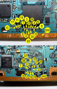

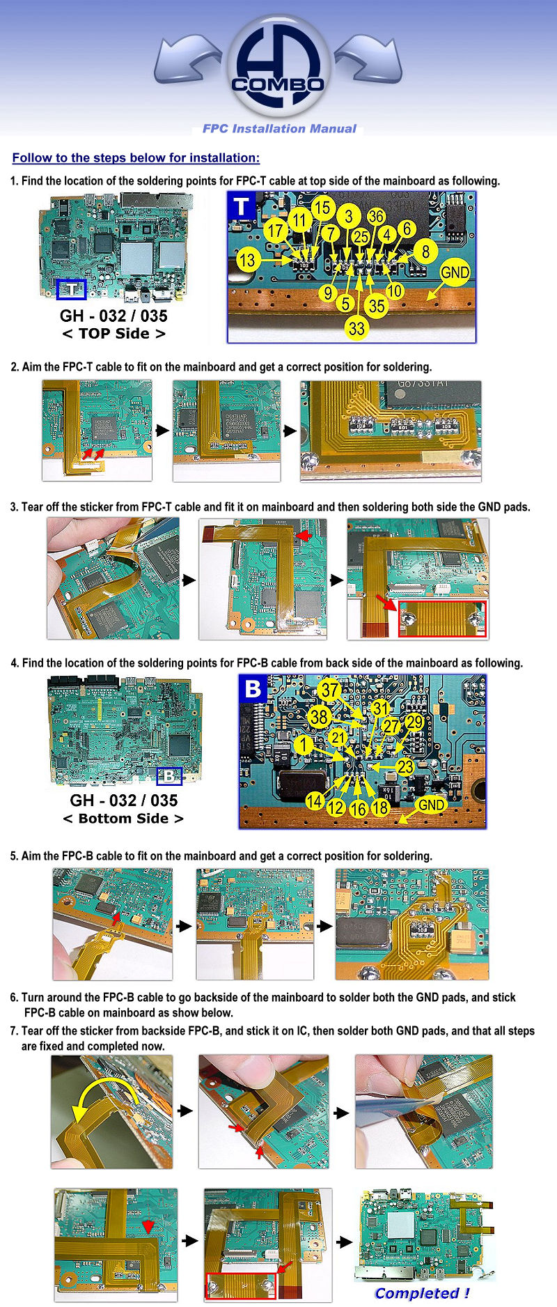

    cześć odświeżę temat ale mam ps2 75004 taśmę ide (taka jak do pc ) i hdd 120gb dajcie schemat jak podłączyć co gdzie przylutować z góry dzięki wrzućcie tu lub na rs pozdrawiam
  • #11 6061473
    Voodoo4
    Posty: 447
    Pomógł: 6
    Ocena: 42
    Pamietaj dysk da sie podłaczyc tylko do wersji SCPH-700XX
    Szuakałem szukałem i wkoncu znalazlem ale jak ktos ma jakies info na ten temat to niech tu wrzuca !

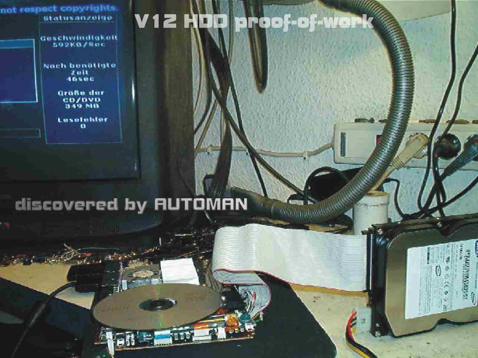

    Jest to tekst przepisany ze strony:
    http://www.maxdiypower.com/index.php?gOo=goods_details.dwt&goodsid=106
    The Hard Drive Connection Tool is a revolutionary product for your 700XX PSTwo. The HD Connect is an
    innovative HD 'connector' allowing you to connect an IDE hard drive for use with the PSTwo Slimline. This is the
    only way to connect an IDE hard drive to your PStwo slimline. There are various USB solutions but the HD
    Connect offers a faster data transfer time. Currently the HD Connect requires the use of DMS4 Pro type chip with
    a compatible BIOS OS.
    Now, with the use of HD Connect, you can simply load original, purchased games onto an attached PS2 hard disk,
    and then run the original, purchased game later on from there. Faster loading, no need to mess with original game
    disks etc. A must have for all PSTwo Slimline users! Ever wanted to load your original, purchased PS2 games onto
    your hard drive and then run them without the hassle of swapping discs? Ever been annoyed by the extremely long
    loading times while reading data from an original, purchased game disc? HD Connect solves these problems and does
    so much more. HD Connect makes gaming more convenient by allowing you to store your original, purchased games
    on an attached hard disk drive, eliminating the need to change discs each time you wish to play a different game.

    If you want to see HDD working status signal LED and want to add a cooling fan for the HDD,just buy a HDD 5" drawer is good for use,it's easy to place PS2+HDD anywhere,easy to carry,easy to remove to another PS2 or plug to PC to install PS2 games!
    if you want to remove or plug HDD,remember shut down PS2,if you want to install or remove the HDD in PC,just buy a IDE to USB adaptor,when you want to remove or plug the HDD,just go to device manager to close the IDE to USB device,don't need to shut down the computer
    Jak samodzielnie wykonać taśmę do podłączenia HDD w PS2 Slim?
    KONIEC !!!
    Tak ze jak komus sie uda odpalic HDD pod PS2 albo ma doswiadczenie to neich da znac :-)
    Ma ktos dojscie do takich tasiemek jak sa zastosowane na tych zdjeciach ? (oczywiscie po rozsadnej cenie) ?
    Jak jest wykrywany dysk przez PS2 czy trzeba jeszcze na plycie podac mu jakies dodatkowe oprogramowanie ?
    POZDRAWIAM

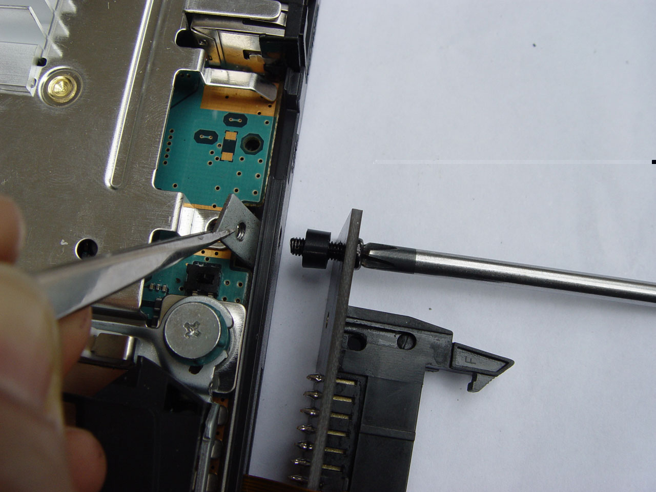

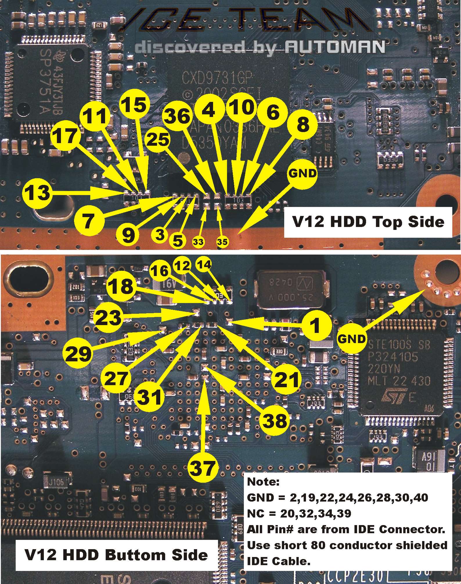

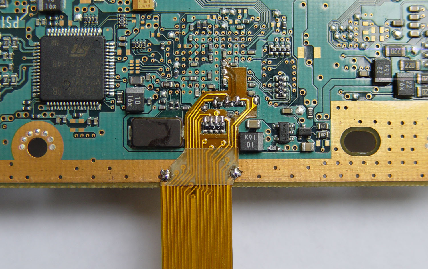

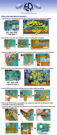

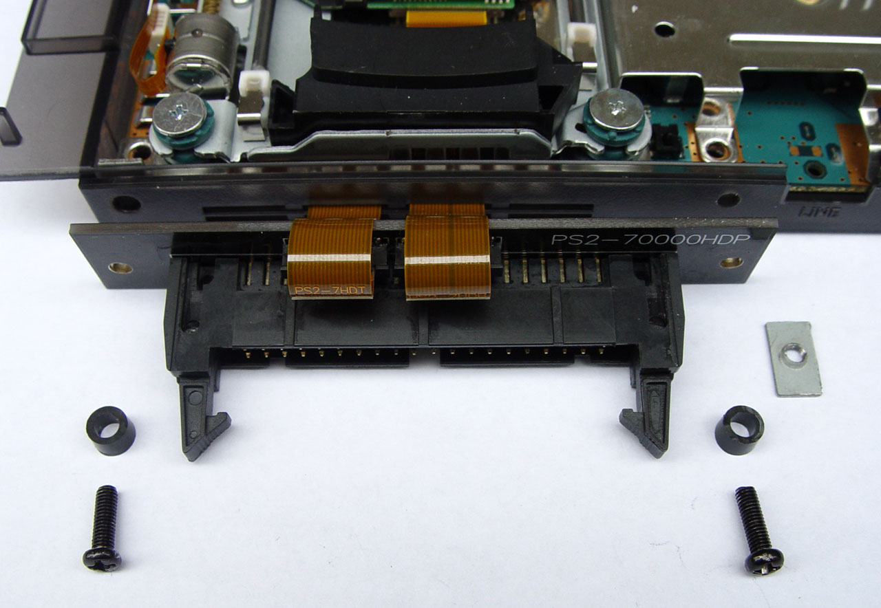

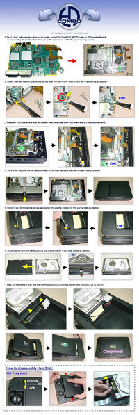

    Jeszcze pare fotek znalezione na jedej z rosyjskich stron.
    Rosja to fajny naród :-)
    Tutaj podłaczenie za pomoca troche innych tasiemek.
    I całość zrobiona na pająka :-)

    Jak dyspunujesz odpowiednim sprzetem i troszke doswiadczenia to robota na max godzine.
    Jak dojdzie do mnie ps to przylutuje ta tasiemke i wyniki jak to działa wrzuce na forum.

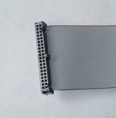

    Czy ktoś próbował przylutować zwykłą taśmę IDE.

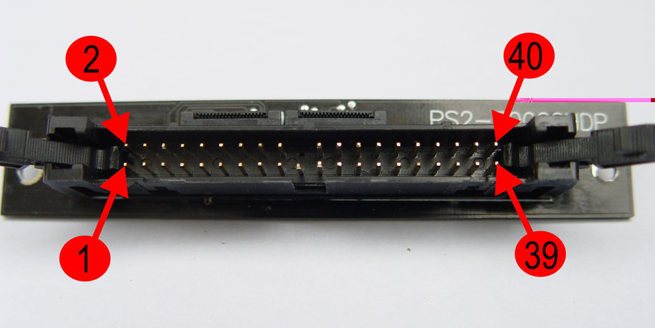

    Może ktoś zorientowany oznaczy na taśmie jak ma być prawidłowo podłączony (prosze oznaczyć numerkami.
  • #19 6886770
    kleha
    Posty: 112
    Pomógł: 3
    Ocena: 17
    :roll: A jak myślisz co to za numerki na zdjęciach które wrzucił kolega Voodoo4 ?? Ale może się mylę :wink:

    Witam, posiadam ps2 z płytą v12 uk. chciałem przylutowac taśme do podłączenia hdd ale widze ze to zbyt skomplikowane dla mnie a nie jestem dobry w elektronice :)
    czy zna ktos może kogoś kto podejmie sie takiego zadania w częstochowie i okolicach?może są jakies serwisy? bądz prywatne uzdolnione osoby?:) byłbym wdzięczny za pomoc, szukałem na necie ale nic :( z góry dziękuje i pozdrawiam.
    P.S. taśm xcm hd connect nigdzie nie można dostac, szukałem wszędzie, czy możliwe jest wlutowanie zwykłej taśmy ide od dysku?
