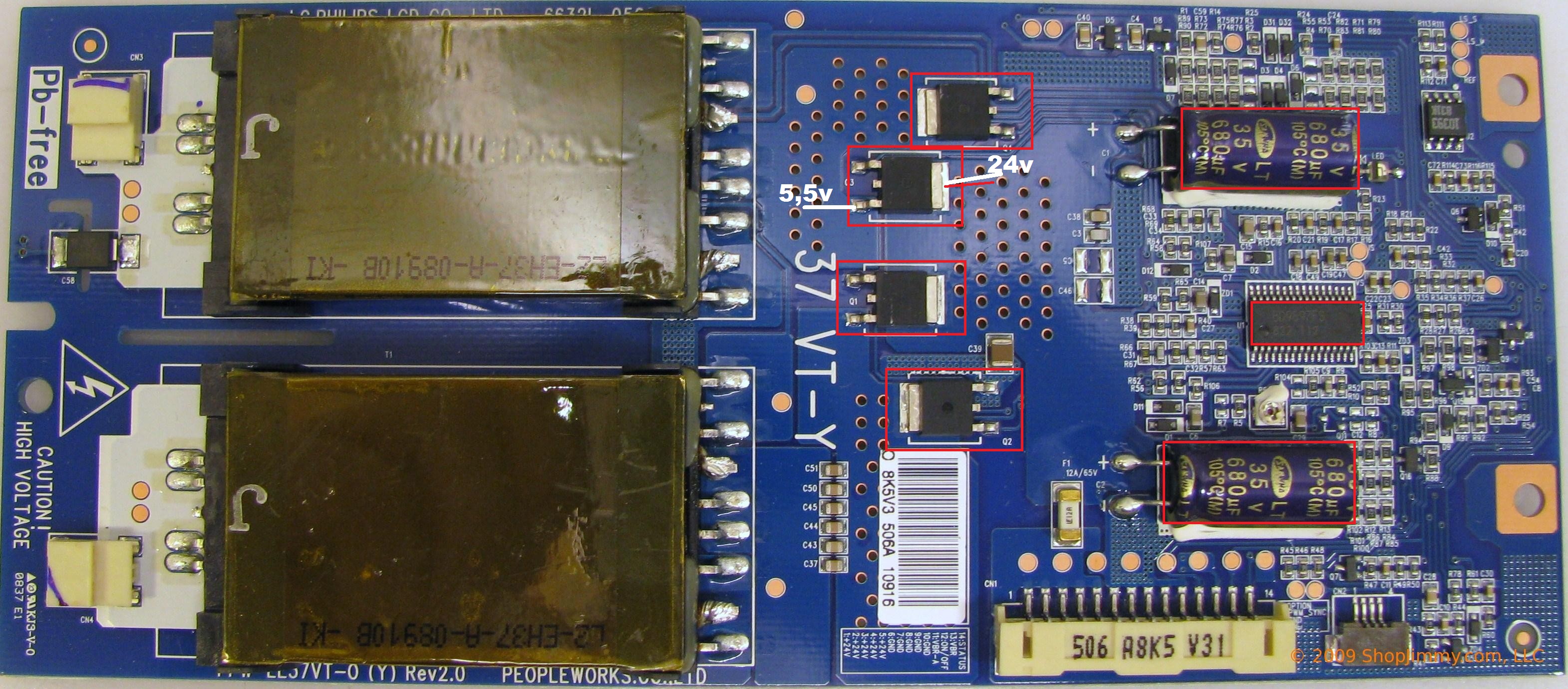

    hello i have a problem with my toshiba 37cv500p, it has sound but no image.
    the invertor modell is 6632L-0506A, i already replaced:
    2x C 680uf/35v
    BD9897Fs
    4x FDD 8447L
    But still no image.
    when i press the power button, there is a led on the invertor board that flashes 2 times but still no backlight. when the led flashed i get 1.8v on the STATUS pin. than it goes to 0v
    i have 5v on the ON/OFF pin
    and at the output of the mosfets i have 5.5v
    any ideeas?
    thank you

  • #7 13850869
    brogdan
    Posty: 11
    here is a photo
    the parts marked with red ARE REPLACED
    and the 2 white lines indicate the values i have measured
    Toshiba 37CV500P - Brak podświetlenia, wymienione elementy, LED miga 2 razy
  • #8 13850908
    guard10
    Posty: 976
    Pomógł: 108
    Ocena: 233
    Hey check ZD1,how is ok connect the capacitors to the CN3 and CN4 2.7nF-3.9nF 3000v.Check as flashing LED

  • #13 13852477
    zbyszekskibinski
    Poziom 33  
    Posty: 2806
    Pomógł: 179
    Ocena: 340
    Hi Brogdan
    If you assume that status pin should stay at 1.8V at all times, why not disconnect that inverter from main board first and see what happens? Just pull out all dimming pins and the status pin from signal board and leave supply pins and ON/OFF pin connected. Check status pin now and if necessary, jump 1,8V in there by drop-down resistor from 24V rail.
    Good luck!
  • #14 13852499
    brogdan
    Posty: 11
    I did that, and from the signal board comes a 3,3v on the status pin, and the invertor board should take it down to 1.8v. it makes it 1.8 v for 1 second and then it grounds the status pin to 0V
  • #15 13852564
    zbyszekskibinski
    Poziom 33  
    Posty: 2806
    Pomógł: 179
    Ocena: 340
    And if this is happening theres no flash on display even for a sec.?Can you hook up your scope on drains of SMD mosfets you outlined red in the picture/the bottom ones/ to see if sqare waveform comes up after inverter start-up? Sometimes CCFLs can light up ok when connected to lamp testers or when ignited individually however they still wont work with the tv they have been fitted in.

    You will need to 'fool' BD inverter controller IC, to bypass CCFL time-out pin first to rule out, CCFLs then, as the inverter might be too sensitive to old and slow-start tubes, however if that was the case, you should be able to see the flash for the second, looks like inverter is defective, test voltages on BD chip, make sure it gets Vcc supply and other voltages according to its PDF file
  • #18 13853530
    brogdan
    Posty: 11
    i checked VCC=24V , standby pin is 5v(ok)
    what elese to check? SS Pin? this is the slow start control. but i don't understand exactly from the pdf... do i need to have a lower voltage than 2.2v on this pin to activate slow start?
  • #19 13853742
    zbyszekskibinski
    Poziom 33  
    Posty: 2806
    Pomógł: 179
    Ocena: 340
    Check pin 17 (CP) and ground it to override CCFL time-out, all in all, I think the problem is still in inverter board, something else has failed on that board, sometimes replacing a full kit won't solve the problem as more components have faulted on the board, sorry can't be of more help...
  • #20 13855141
    brogdan
    Posty: 11
    thank you for your time, i grounded pin 17 but still no backlight..
    i also measured all the other tansistors and diodes on the invertor board, and can't find anything wrong
    just don't know what to do more
