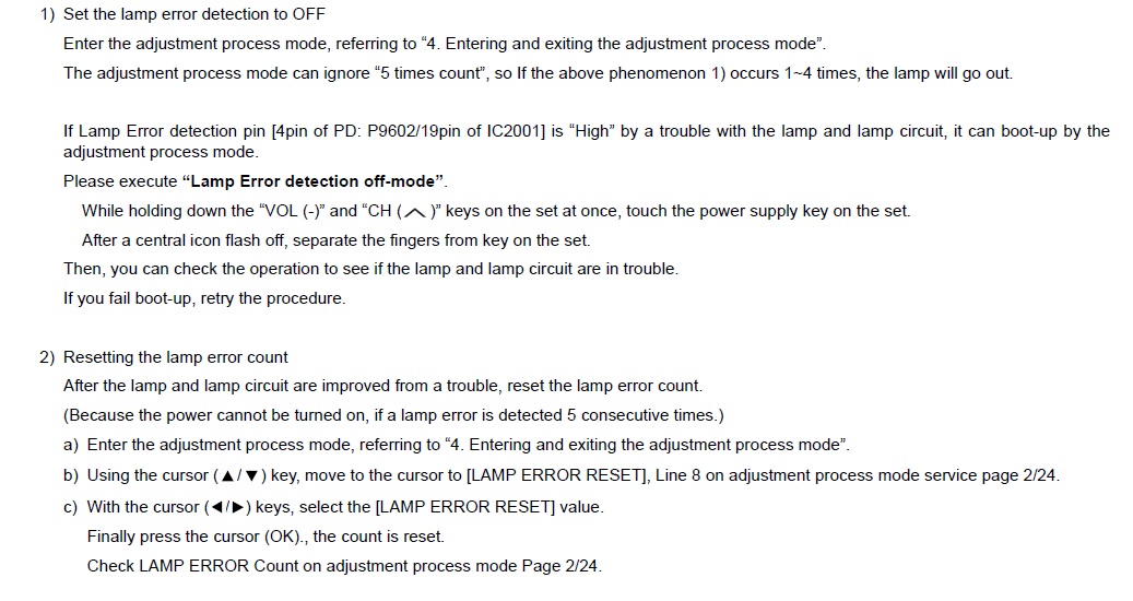

    Po naprawie podświetlenia, nie mogę wejść w tryb serwisowy,
    żeby zresetować błąd podświetlenia.
    Metodą Volume - i CH + lub Volume + i INPUT
    Na 4 pin P9602 jest stan niski.

    #7 17108298
    lisek
    Serwisant RTV
    Posty: 39927
    Pomógł: 6340
    Ocena: 6862
    W temacie Link_ LC-40LE830E - Jak wejść w tryb serwisowy w tym TV napisano
    Sterowanie TV ma dotykowe
    "Entering and exiting the adjustment process mode :
    1) Before entering the adjustment process mode, the AV position RESET in the video adjustment menu.
    2) At the state TV is turned on, touch the power key for 5seconds.
    NOTE: Picture will disappear when you touch the power key, but keep touching the power key.
    3) When the center icon LED blinks, release your finger from the power key.
    4) Next, touch the “POWER” key with the “VOL (—)” and “INPUT” key touching.
    TV will turn on and the letter “<K>” appears on the screen.
    5) Next, touch the “VOL (—)” and “CH ( )” keys at the same time.
    6) When the center icon LED turns on, release your finger from the keys.
    (The “VOL (—)” and “CH ( )” keys should be pressed and held until the display appears.)
    Multiple lines of blue characters appearing on the display indicate that the unit is now in the adjustment process mode.
    When you fail to enter the adjustment process mode (the display is the same asnormal startup), retry the procedure.
    7) To exit the adjustment process mode after the adjustment is done, unplug the AC cord from the outlet to make a forced shutdown. (When the
    power was turned off with the remote controller, once unplug the AC cord and plug it again. In this case, wait 10 seconds or sobefore plugging.)
    CAUTION: Use due care in handling the information described here lestyour users should know how toenter the adjustment processmode. If the
    settings are tampered in this mode, unrecoverable system damage may result"
  • #8 17108607
    mailo
    Posty: 1315
    Pomógł: 82
    Ocena: 339
    Co i jak w załączniku.
    • Sharp LC-40LE830E - problem z wejściem w tryb serwisowy po naprawie lamperror.jpg (166.01 KB) Musisz być zalogowany, aby pobrać ten załącznik.

    Okazało się, że było zepsute lokalne dotykowe,
    podmieniłem na drugie, i jest okej.
