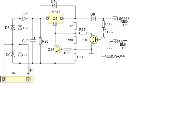

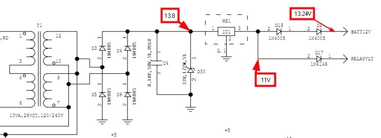

    Na płytce 640-0395B-Z_REV02
    APC Back-UPS Pro 550 BR550GI - Brak ładowania akumulatora
    PowerCom KIN 425/625AP ( z ogranicz. pradowym)
    Rys.1 i rys.2
    APC Back-UPS Pro 550 BR550GI - Brak ładowania akumulatora APC Back-UPS Pro 550 BR550GI - Brak ładowania akumulatora
    Uwyj. (Uład.) ustala R7/R38. Czujnik prądowy (ustala prąd ogranicz,) R51
    Ponizej opis dotyczy rys.1
    Spoiler:
    VOLT_SELECT, which is a discrete signal and is generated by a microprocessor. This signal changes the parameters of the resistive divider that sets the output voltage of the stabilizer, and in particular the resistance of the "lower" resistor (R2 in Fig.4). Setting the VOLT_SELECT signal to a high level opens the transistor Q12 and locks the Q7. As a result, the" lower " resistor of the divider becomes the resistor R15. Setting the VOLT_SELECT signal to a low level leads to the opening of the transistor Q7 and closing Q12, resulting in a "lower" resistor divider becomes R17 C other resistance rating, which ultimately leads to a change in the output voltage of the charger.
    Switching on and off the charger is carried out by the signal on / OFF and transistor Q18, when you open the control terminal of the stabilizer LM317 (cont.1) shunted to the "ground". Current limitation, as usual, is carried out by the transistor Q19, which, in turn, is controlled by the current sensor – resistor R35.
    In the diagram shown in Fig.11 you can also see the presence of a charger sensor consisting of R53, R45 and C19. This sensor generates a CHRG_ON signal as soon as the supply voltage of the primary network appears at the UPS input. This signal with its high level informs the microprocessor about the presence of the mains voltage and the possibility of starting the battery charging process. It is on this signal that the microprocessor sets the on/OFF signal to a low level, which leads to the start of the charger. In principle, this sensor could be called a network voltage sensor.
