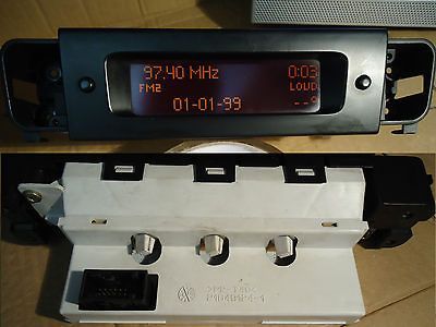

    hello I have problem with tipping code...
    renault radio model 22DC277 or similar models whether they can be connected on the table with the display I have a display of peugeot 406.18 pins..or which I have to get connecting the radio and the display on the desk for service and entering code

    Peugeot display will not work with Renault radio - other communication.
    In 22DC277 (Tuner List) you can turn off the code by programming the memory and the radio will work on the table. The display is not needed to start.
    Wyświetlacz Peugeota nie będzie współpracował z radiem Renault - inna komunikacja.
    W 22DC277 (Tuner List) można wyłączyć kod programując pamięć i radio będzie pracowało na stole. Wyświetlacz nie jest potrzebny do uruchomienia.

    I need a display and a connection to enter the code, so I don't change the dump

    Then you have to buy the display dedicated to the radio Tuner List and make yourself the appropriate wiring.

    yes yes i have already ordered the display but i need the wiring diagram ... same for the opel gid radio and the display on the table...
    you helped me connect the peugeot 406 display and the clarion radio.
