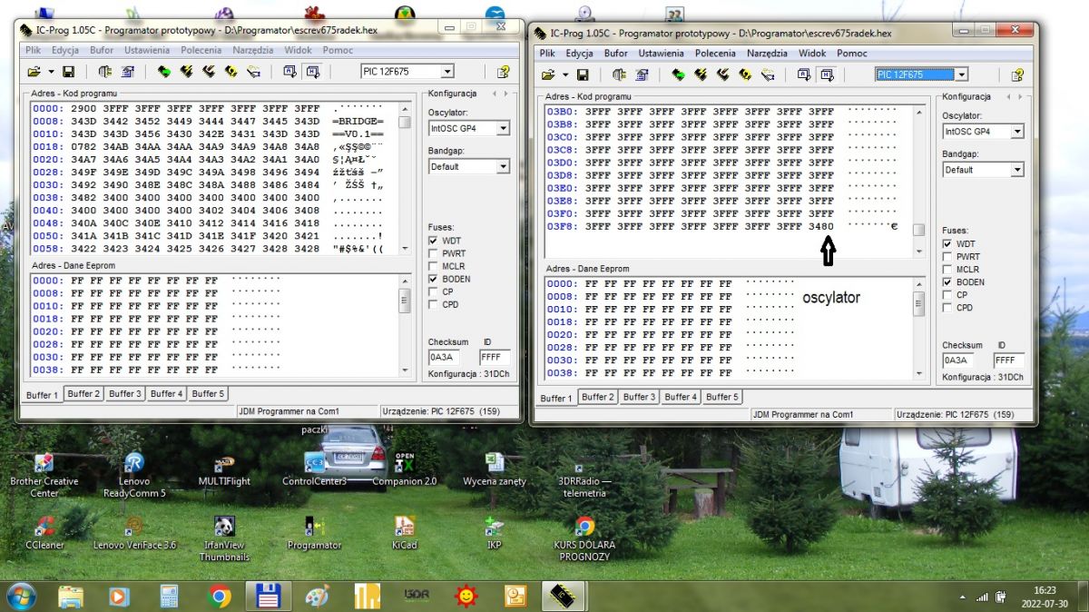

9.2.5.1 Calibrating the Internal Oscillator napisał:Note: Erasing the device will also erase the preprogrammed internal calibration value for the internal oscillator. The calibration value must be saved prior to erasing part as
specified in the PIC12F629/675 Programming specification. Microchip Development Tools maintain all calibration bits to factory settings.
