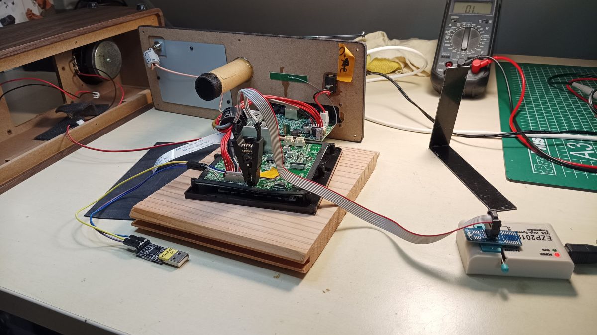

    My DabMan i200 has the same problem. FM tuner, DAB() tuners deaf and no sound from the speakers, in whatever mode. The update from "https://drive.google.com/file/d/1aTNoPn9XX6pEybS0KY-Rp7drCO-V4BcN/edit" gave me some hope but the USB software update failed.
    I opened the unit. The firmware is stored in a W25Q64, a 64 Mb or 8 MB SPI_Flash. The firmware on Google is only 4 MB.

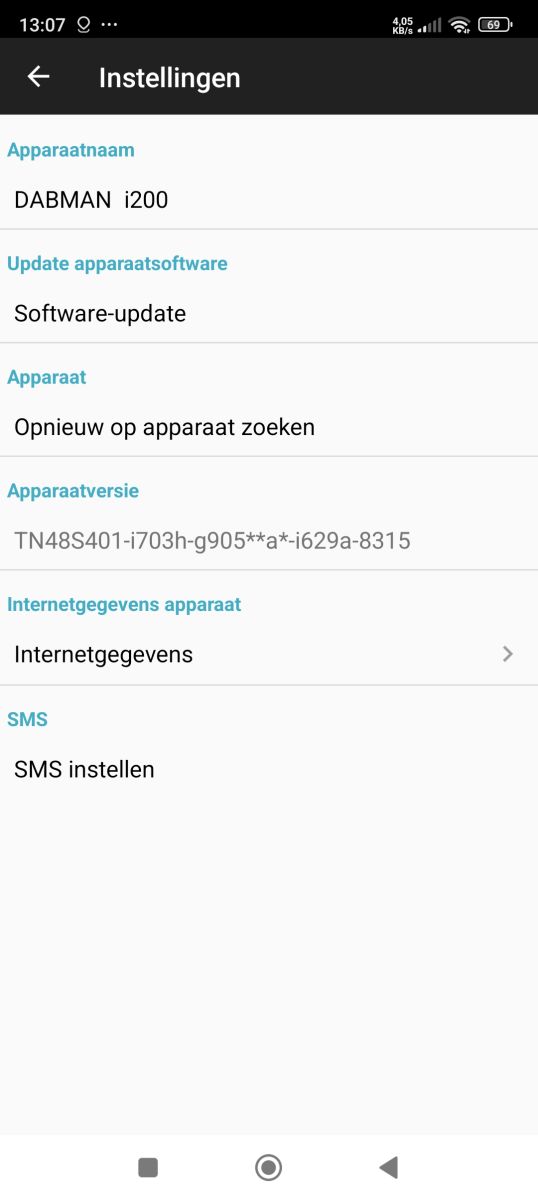

    I used an EZP2019 to read the flash and verified, it is indeed 8 MB code. Version is:
    Zrzut ekranu ustawień urządzenia z nazwą DABMAN i200 i wersją oprogramowania
    The YouTube video is based on a different version i200 because the PCB in my i200 differs.
    The debug terminal works and shows no disastrous errors
    Otwarta obudowa radia z podłączonym programatorem EZP2019 do płytki PCB
    Startup output is Linux based:

    It would be nice if a copy of an operational i200 flash copy will become available.
    My first try was a USB software update with only the file "flashbin" in the root. (I didn't know better) That gave an update error on the display.
