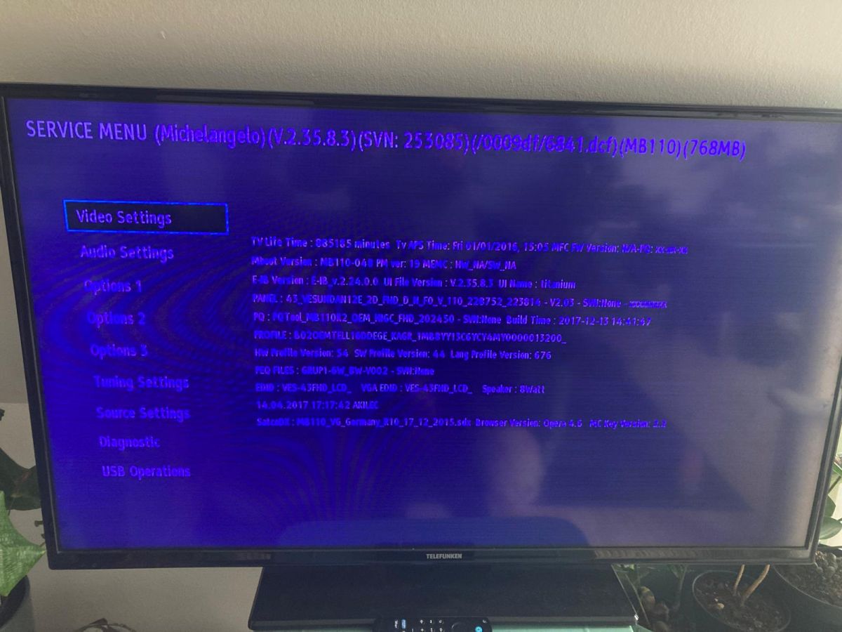

    Hello,
    I’m looking for the original or compatible firmware for a Telefunken TV, model D43F287M4CW, based on MB130 mainboard and panel VESDUN43D_NF.
    The TV is currently not saving any picture settings. Every time it turns off, all image adjustments (color, white balance, etc.) are reset. Even after enabling Flash Write Debug in the service menu, the issue persists.
    I couldn’t find any update from the manufacturer (Vestel), and they confirmed they don’t provide software updates for this model.
    Any help with a working firmware or a dump file from a similar TV with MB130 and FHD panel would be very appreciated.
    Thanks in advance!

    Post a picture of the service menu.

    Here is the picture of the service menu from my Telefunken D43F287M4CW TV.
    Mainboard: MB110
    Firmware Version: V2.35.8.3
    Panel: 43_VESDUNIAN12E_2D_FHD_D_N_F_V
    UI Name: Titanium
    PQ: PQTool_MB1102_OEM_HIGC_FHD
    Build Time: 2017-12-13
    Browser Version: Opera 4.6
    Let me know if you need any other information. Thank you again for your help!

    1. Main is 17MB110 not 17MB130
    2. Panel is VES430UNDA-2D-N12 not VESDUN43D_NF
    3. Software version is 2.35.8.3 not V.7.53.83
    The image is blue. You have backlight problems.
    I have this. It installs with MENU 1505. Unarchived. Try at your own risk.

    I followed your instructions and flashed the USB with the firmware file (upgrade_mb110.bin), then connected it to the TV and powered it on.
    However, the TV just booted normally — it didn’t enter the update mode.
    I also opened the back of the TV to look for a button labeled “SW2” or any reset/update button on the mainboard, but I couldn’t find any visible switch. It seems like my MB110 board doesn’t have a physical SW2 button, or it’s not labeled.
    Do you know if there’s any other way to trigger the firmware update on this board? Maybe a key combination or a hidden method?

    I wrote:It installs with MENU 1505.
