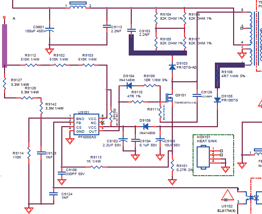

    Power Supply LED Driver 715G7734-P01-000-0020 Philips
    TPN16.2E LA
    TPN16.3E LA
    TPM16.1E LA
    QM16.4E LA
    TPM16.3L LA
    TPN16.1HE LA
    TPN16.1E LA
    TPM16.4L LA
    TPM16.5L LA
    32PHD5813/55
    32PHG5813/78
    32PHG5813/77
    32PHG5833/77
    32PHD5813S/94
    U9101 PF6005AS
    U9301 NC/AOZ3015AI
    U8601 PF7708BS
    • Power Supply LED Driver 715G7734-P01-000-0020 Philips.pdf (482.06 KB) Musisz być zalogowany, aby pobrać ten załącznik.
