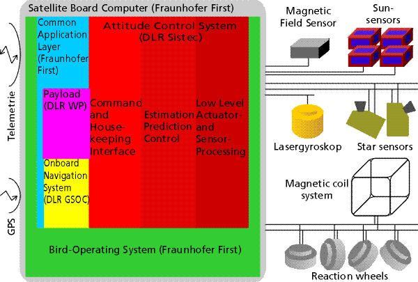

    Najciekawszy z pośpiesznie znalezionych dokumentów godzi wszystkich. Pokazuje równoczesne zastosowanie kilku metod nawigacji, łącznie z żyroskopem (co prawda laserowym, w kółko latają tylko fotony) oraz kilku metod poruszania satelitą z kołami reakcyjnymi (a może bezwładnościowymi; to właśnie te żyroskopy w wersji napędowej) i ukladem cewek do oddziaływania z magnetosferą.
    http://www.dlr.de/sc/en/DesktopDefault.aspx/tabid-1205/1631_read-3202/
    The lowest layer of the attitude control system is the layer low level actuator and sensor processing. This layer establishes the interfaces to the sensors and actuators needed for the attitude control. The attitude control system possesses four kinds of sensor types. These are a magnetic field sensor and two sun sensor systems as non-intelligent sensors coupled over an A/D interface to the main board computer. Furthermore one laser gyroscope and two star sensors as intelligent sensors are used. The laser gyroscope is coupled over a communication bus with the board computer and sends with a rate of 5 ms a packet with information for the rotation of the satellite. These data packetes are consolidated by the attitude control system to 500 ms cycles. Both star sensors are connected by two communication busses to the board computer. The attitude control system drives both star sensors in exact timing with two state machines and queries cyclically the attitude data from the cameras. As actuators four reaction wheels in a tetrahedic arrangement and a magnetic coil system with six coils are available. All actuators are coupled with the board computer over two communication busses. The lowest layer determines the necessary commanding for the actuators from the torques computed by the layer estimation prediction control. It performs the time critical communication with actuators and determinates the state of the actuators. For communication with both star sensors and the actuators over two communication busses the lowest layer provides a
    [to nie ja obciąłem, tak jest w dokumencie ???]

  • #16 2997340
    opel4
    Posty: 19
    Ocena: 2
    Reaction wheel z rysunku powyżej to jest właśnie układ żyroskopów służących do poruszania satelitą.
    Uzupełniam informację.
    nasa napisał:
    Spin momentum in the
    wheels moves the telescope to a target and maintains
    it in a stable position.
    Źródło
