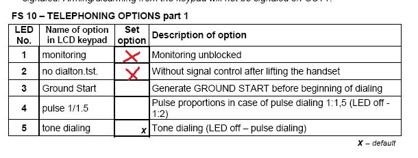

    Witam ;
    I have a problem with the phone line in satel ca5 i connect the line to the tip and the ring ; in fs 52 i put the number phone and fs 56 the identifier but it doesn't work the alarm doesn't call the number phone are there another configurations !! please help me.
    Thank you.

  • #4 10243892
    adibaw
    Posty: 266
    Pomógł: 12
    Ocena: 22
    and fs 54;fs 55 It inscribe options 13

    Hello,
    Functions for telephone test are FS-69, FS-70, FS-85. You mast control parameters in this functions. If You need disable phone test, in FS-69 set: 9999, in FS-70 set: 000000 , the same in FS-85: 000000.

  • #10 10303030
    DZ23DZ
    Posty: 12
    i changed the : FS 54, 55 – FORMAT OF DATA TRANSMISSION to 13. 0 no handshake (Silent Knight, Ademco 10BPS –without confirmations) ;and it work correctly
