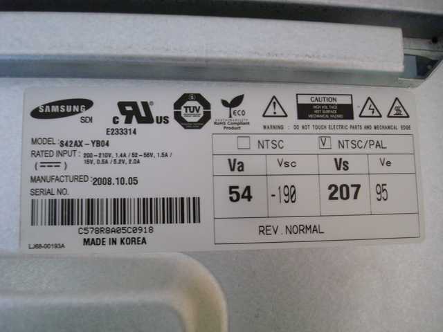

    My tv is a samsung plasma ps42A451 version BO05. After twice missing short power supply tv started after power on every 30 seconds "of turn" end turn on. When I set up the sevice menu item instead of "ready off" to "ready-on" tv began working steadily. Is that okay? I worried that it was not a protective mode and whether the service should? Thank you.

    It is chassis chassis F53A , non-full service manual on
    https://www.elektroda.pl/rtvforum/topic17936-210.html#9108585
    Other informations
    Link
    Y-MAIN LJ41-06004A,
    X-main LJ41-06003A
    PSU: DYP-42W3 = Samsung BN44-00204A Power Supply
    Logic control: LJ41 05078A (LJ92-01485) (test panel (CN2007-1+2 short))
    Main BN94-01762F, on the processor Samsung SEMS01
    panel S42AX-YB04(42HD W3)
    Problems is Main (Flash MX25L1605A ) or PSU (PSU can be checked separately on the table)
    If y have still from Main PS_ON =5V and VS_ON (3.7V) from ctrl problem flash,
    EEprom (IC5004-ATMLH834= AT24C256 ) must be write as FF

    Thanks for the link and reply. Just one more question. When I was in the service menu changed option to "ready on" TV is operating normally. I found a post where they say that the option for TV with DVB-T tuner my TV is without this. Is it OK that this option remains "ready on"?
