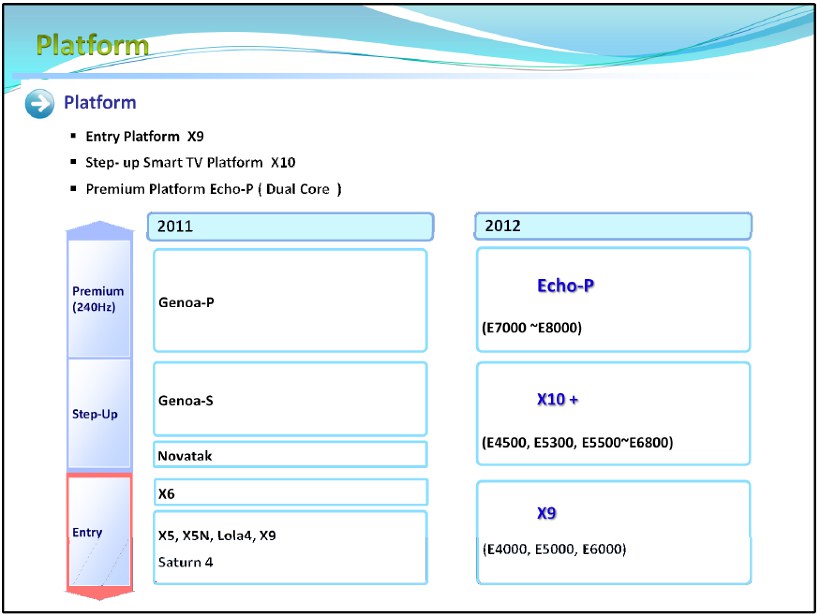

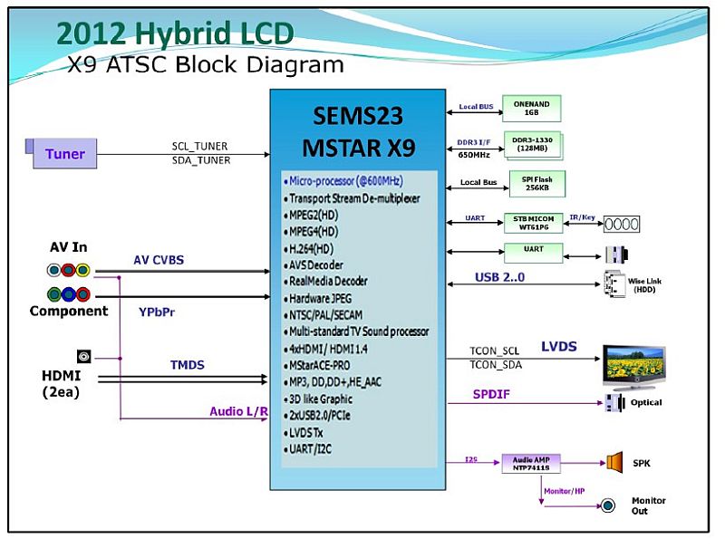

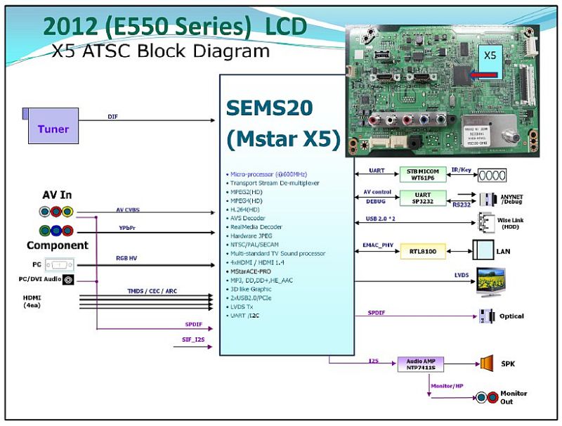

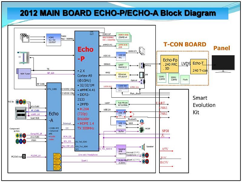

    Model - Firmware - processors
    E420 -> E450 T-MST9 DEUC-1002.0 X9 -> MStar X9 600Mhz MStar
    EH4003 -> EH6003 T-NVT E4DEUC -> Novatek E4 Welcome to Novatek
    EH4000 -> T-EN5000-MST9 DEUC 1,002.0 X9 -> Mstar X9 600Mhz Mstar
    EH5300 -> EN5450 T-MST10-PDEUC 1,005.2 X10 -> X10 900Mhz Mstar Mstar
    ES5500 -> ЕS6800 T-MST10 PDEUC-1005.2 X10 -> MStar X10 900Mhz MStar
    ES7000, ES7500, ES8000 T-ECP DEUC-0145.6 -> Echo-P CPU-Dual-core ARM Cortex-A9 1Ghz GPU-Mali-400 MP4
    np. UE32EH4030, matrix - LTJ320AP03-L MB: BN94-05546H
    Nowa linijka samsunga na 2011/2012 niskobudżetowa
