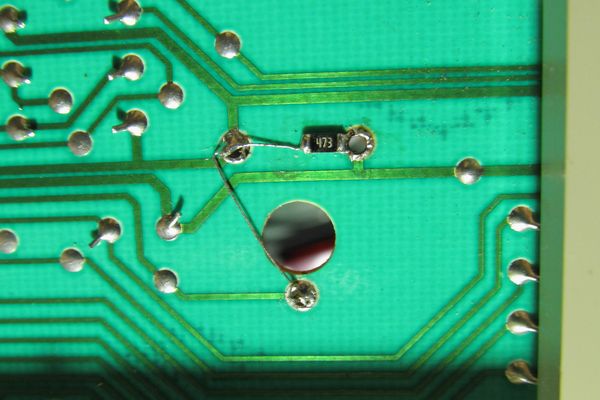

    I have a problem with Novatherm ZW20KD: the heating continues even when regulator on the boiler is in "summer" position:
    Junkers Novatherm ZW 20 KD - letni tryb pracy / summer mode not working
    It seems that this regulator is not working at all, boiler keeps firing every several minutes regardless of regulator position and current temperature. What reasons can cause this? What of this reasons can be fixed or checked by myself? If repair is too complicated, is there a way to just disable heating for now (to make it work in summer mode permanently)? For example by plug in there

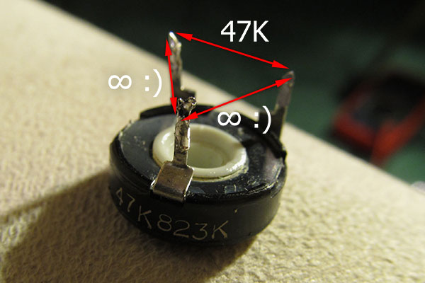

    Może być uszkodzone ( złamane) pokrętło do regulacji c.o. Może też być wytarty potencjometr na płycie. By wyłączyć c.o. można wypiąć zworę ze styków 1, 4.

    ... two hours later
    Guilty!
    Testing if everything else works... :)
    Pins 1 and 4 are shorted and everything is fine (no CO but CWU ok)
    So it looks like I just need to find a new potentiometer :)
    Thanks for help!
