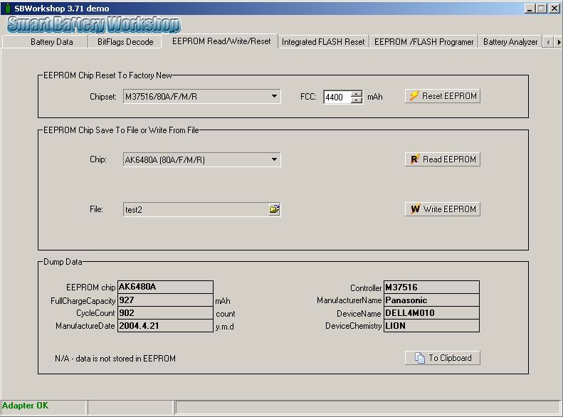

    Hello
    Battery in my old and trusty Dell D600 suddenly "died". Status LEDs on battery blinks few times and charging LED on D600 blinking red. Because I have some spare cells for other projects I decided to replace them. But no success, no difference. Looks like battery electronics needs a reset.
    I googled a lot these days. ;) Now I have a working adapter and I can read and write eeprom.
    Dell D600 - wymiana komórek i reset elektroniki baterii, ustawienie pojemności na 6000mAh
    Is there anyone who can reset my bin file and if possible set capacity to 6000mAh?

    Yes I have demo version of SBWorkshop 3.71 (btw: link for buying is not working) and I have adapter.

    no keď dobre vidím :
    1.vyčítaš eprom
    2.zresetuješ eprom
    3.zapíšeš eprom
    a hotovo

    It's probably true if you have the full version. I have Demo.

    Does not work. It's not that easy. The serial number is probably calculated from RegName and HDD_ID, which is unique to each computer.
    So again ... is there anyone here who can help me and reset the attached bin file? Thanks!
