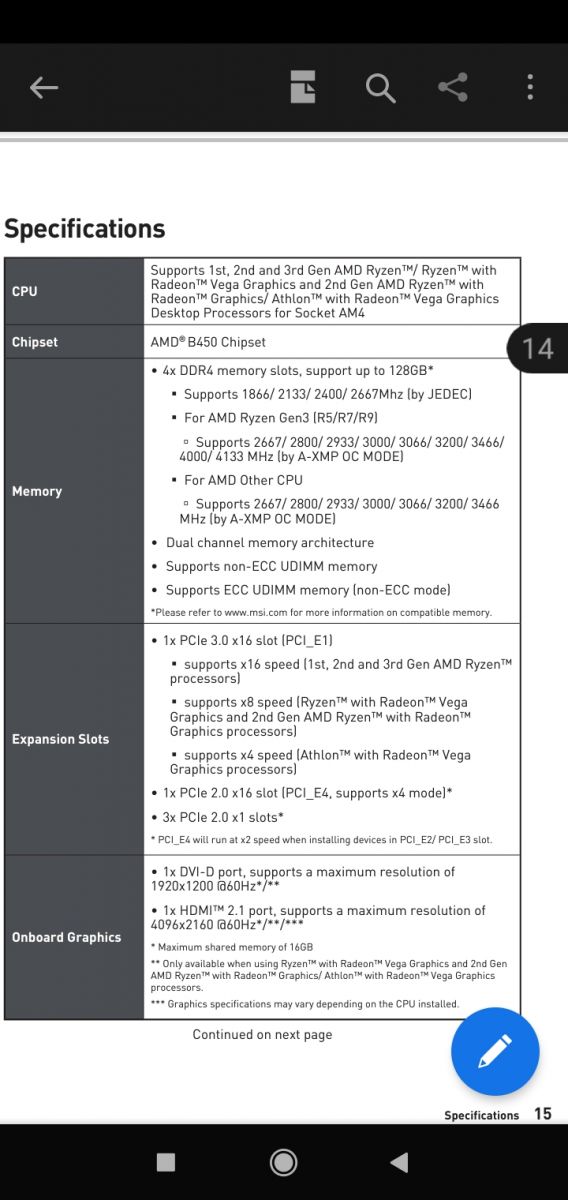

    When you turn on computer,before it goes to windows,on first screen that you see it will be info about processor,memory ,hdd ... When you see that you can hit pause button on keyboard if it passes quickly,so that you can see actually info about procesor. The other thing is,that as I see in user manual for your motherboard the memory module to support Cpu speed of your procesor it has to be put in A-XMP oc mode, if both cpu and memory module support A-XMP then you can turn it on in bios. If memory module does not support this function it will be disabled in bios and you can not turn it on. Procesor działa na mniejszym taktowaniu niż powinien

    XMP mode is for RAM, I have turn it on
