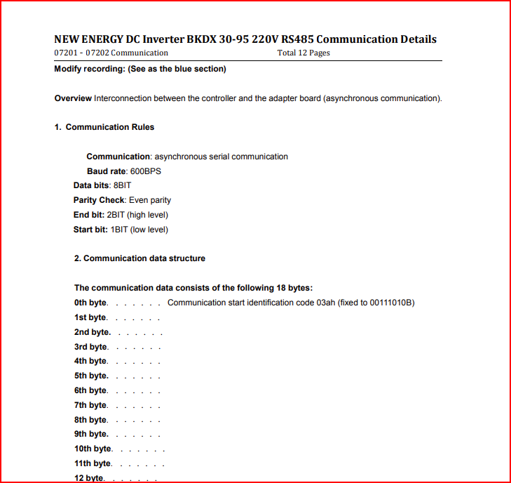

    I found this forum looking for a RS485 and/or modbus desciption for the Nulite BKDX30-200II on the internet. I already have a document with the NEW ENERGY DC Inverter BKDX 30-95 220V RS485 CommunicationDetails.
    Screenshot dokumentu dotyczącego komunikacji RS485 dla NEW ENERGY DC Inverter BKDX 30-95 220V.

    >>20961143
    Communication Rules
    Communication: asynchronous serial communication
    Baud rate: 600BPS
    Data bits: 8BIT
    Parity Check: Even parity
    End bit: 2BIT (high level)
    Start bit: 1BIT (low level)
