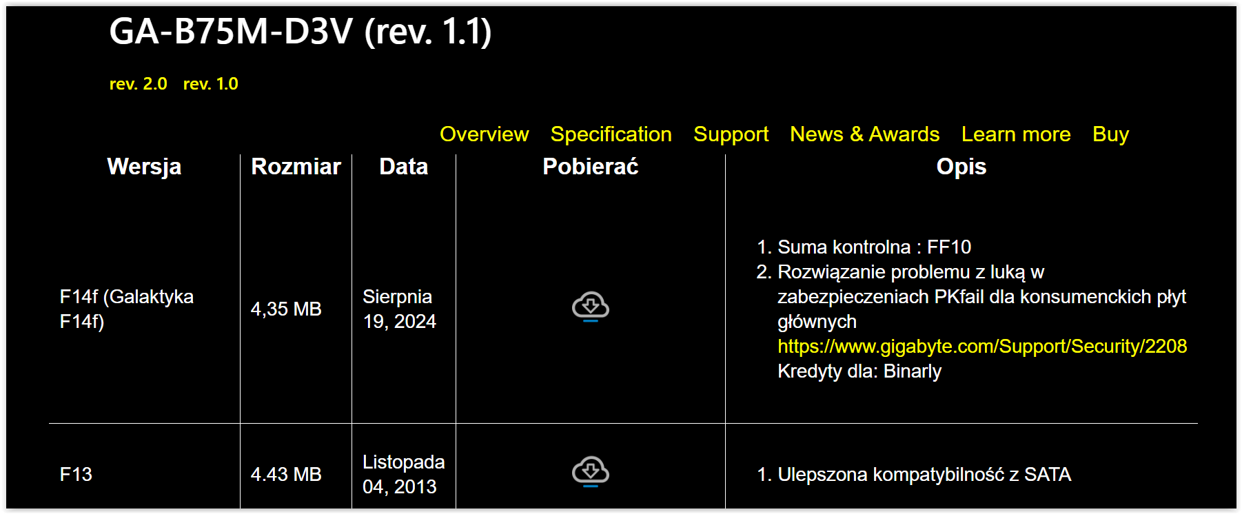

    A co z aktualizacją BIOS-u?
    Tabela z informacjami o aktualizacjach BIOS-u dla płyty głównej GA-B75M-D3V (rev. 1.1).

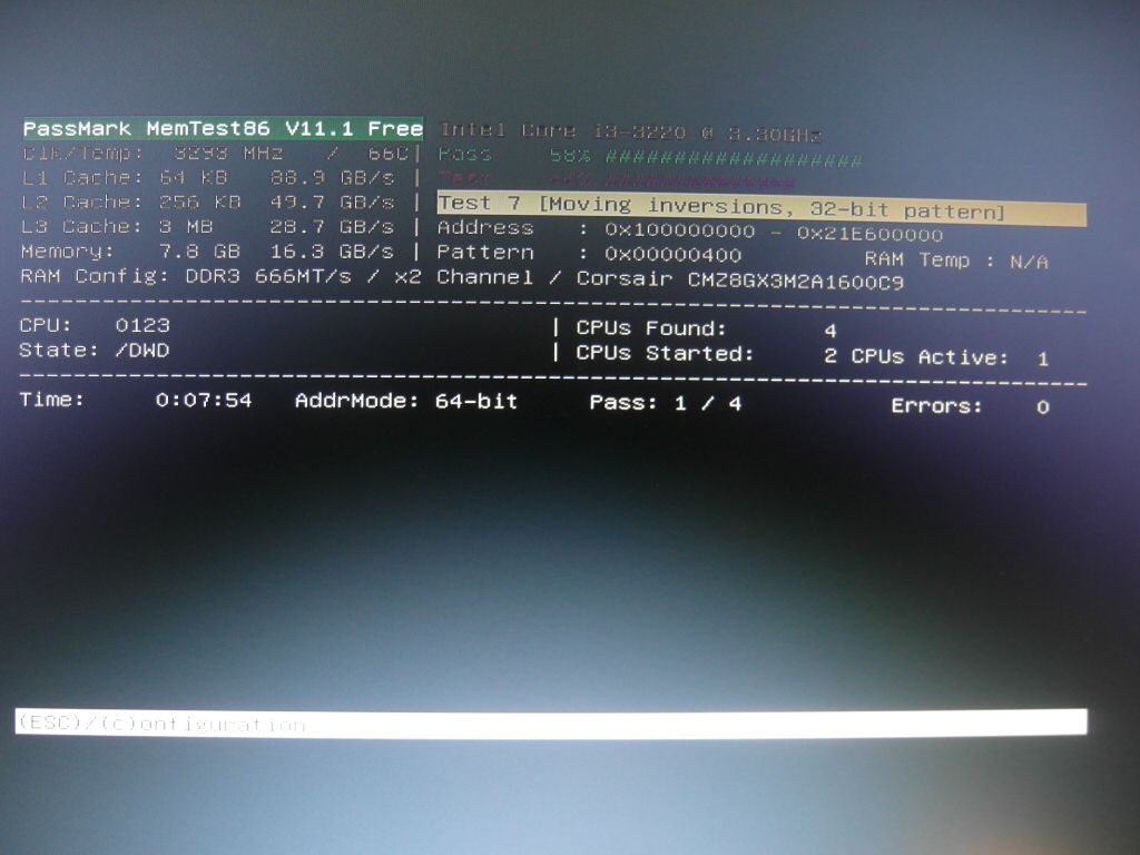

    pidar napisał:
    Chodzi o końcowe już prawidłowe obsadzenie tych dwóch kości RAM-u dla trybu "dual".
    A to jest jakaś procedura, bo ja wkładam jak wypadnie, hehehe
    Bios f14 mam już od kilku dni, znalazłem go jak padł mi komputer/Bios pierwszego dnia z pomocą Kolobosa uruchomiłem drugą kość. Teraz testuję RAM, może się dzisiaj skończy ;)
    Zrzut ekranu programu PassMark MemTest86, wyświetlający test pamięci RAM z wynikami i statystykami.

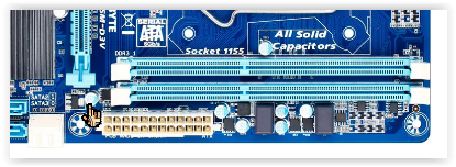

    Czytaj:
    Spoiler:
    Installing the Memory
    Dual Channel Memory Configuration
    This motherboard provides two DDR3 memory sockets and supports Dual Channel Technology. After the memory
    is installed, the BIOS will automatically detect the specifications and capacity of the memory. Enabling Dual
    Channel memory mode will double the original memory bandwidth.
    The two DDR3 memory sockets are divided into two channels and each channel has one memory socket as
    following:
    Channel A: DDR3_1
    Channel B: DDR3_2
    Read the following guidelines before you begin to install the memory:
    • Make sure that the motherboard supports the memory. It is recommended that memory of the
    same capacity, brand, speed, and chips be used.
    (Go to GIGABYTE's website for the latest supported memory speeds and memory modules.)
    • Always turn off the computer and unplug the power cord from the power outlet before installing the
    memory to prevent hardware damage.
    • Memory modules have a foolproof design. A memory module can be installed in only one direction.
    If you are unable to insert the memory, switch the direction.
    Due to CPU limitations, read the following guidelines before installing the memory in Dual Channel mode.
    1. Dual Channel mode cannot be enabled if only one DDR3 memory module is installed.
    2. When enabling Dual Channel mode with two memory modules, it is recommended that memory of
    the same capacity, brand, speed, and chips be used for optimum performance.
    Płyta główna z gniazdem Socket 1155 oraz komponentami elektronicznymi w kolorze niebieskim.

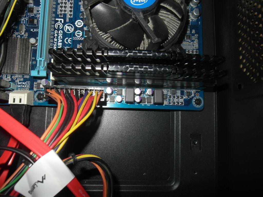

    Memtest mieli już ponad 3 godziny, errors pass #1,2,3 ="0"
    Teraz nie mogę wyciągnąć Ram-ów, czy w ogóle ten test dzisiaj się skończy...a na tej fotce chyba niewiele zobaczysz.
    Płyta główna komputera z zainstalowanymi modułami RAM i przewodami.

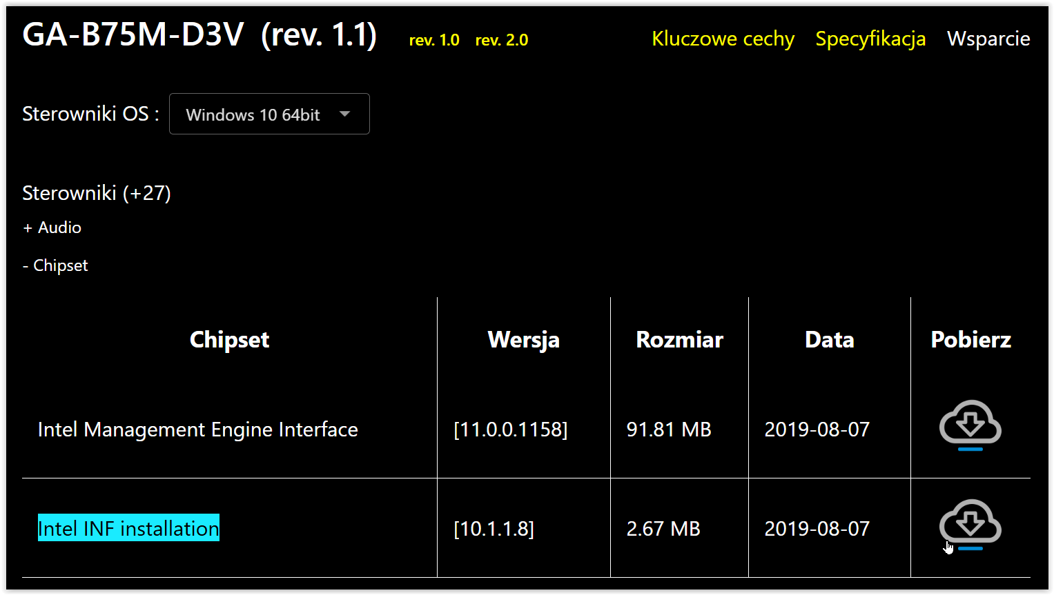

    MM2X napisał:
    Teraz nie mogę wyciągnąć Ram-ów ...
    i już nie wyciągaj!
    A po zakończonym teście bez errorów, przystąp do instalacji systemu, bo nowy SSD już chyba założony?
    I jeśli po instalacji systemu stwierdzisz, że coś brakuje, to rozpoczynasz od:
    Zrzut ekranu strony z driverami płyty głównej GA-B75M-D3V.

    A jak to stwierdzić?, gdzie sprawdzić? - to właśnie zawsze mój największy problem przy nowych instalacjach.
    W menedżerze urządzeń nie mam żadnych wykrzykników.

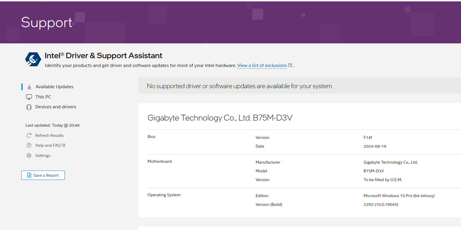

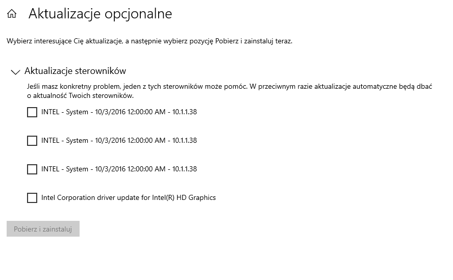

    I teraz zagwozdka, instalować aktualizacje Intela pobrane przez Update, czy też nie, bo Intel wskazuje, że na ten komputer nie ma żadnych aktualizacji. I bądź tu chłopie mądry.
    Zrzut ekranu z opcjonalnymi aktualizacjami sterowników w Windows 10
    Zrzut ekranu z Intel Driver & Support Assistant, który informuje o braku dostępnych aktualizacji sterowników dla systemu.
