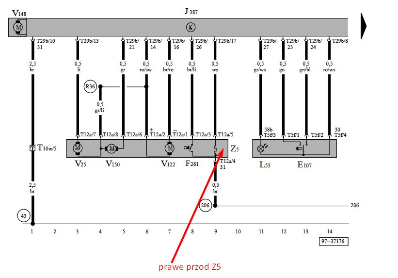

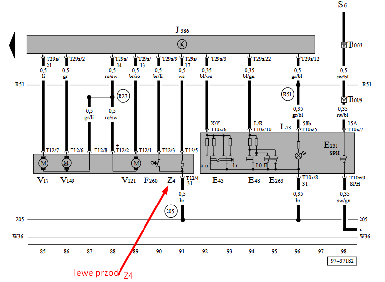

    Schemat elektryczny z zaznaczonym miejscem Z4 opisanym jako lewe przód.
    Schemat elektryczny z opisem przewodów i oznaczeniami komponentów, z czerwonym napisem wskazującym „prawe przód Z5”.

    Cześć,
    Czy te schematy to moduł komfortu?
    Bo ja nie jestem elektrykiem, ale pomierzyć mogę.

    Front passenger door control unit, front passenger door window regulator switch, heated exterior mirror on front passenger side, folding mirror, mirror adjustment
    E107 - Window regulator switch in front passenger door
    F261 - Front passenger side fold-in mirror contact switch
    J387 - Front passenger door control unit
    L53 - Window regulator switch illumination bulb
    T5f - 5-pin connector, black
    T10w - 10-pin connector, black, right A-pillar coupling station
    T12a - 12-pin connector, black
    T29b - 29-pin connector
    V25 - Mirror adjustment motor (front passenger side)
    V122 - Front passenger side fold-in mirror motor
    V148 - Front passenger side window regulator motor
    V150 - Front passenger side mirror adjustment motor
    Z5 - Heated exterior mirror on front passenger side
    43 - Earth point, lower part of right A-pillar
    206 - Earth connection, in front passenger door wiring harness
    R36 - Connection (mirror adjustment), in front passenger door wiring harness
    Driver door control unit, mirror adjustment and mirror fold switches, heated exterior mirror on driver side
    E43 - Mirror adjustment switch
    E48 - Mirror adjustment changeover switch
    E231 - Exterior mirror heater button
    E263 - Fold-in mirror switch
    F260 - Driver side fold-in mirror contact switch
    J386 - Driver door control unit
    L78 - Mirror adjustment switch illumination bulb
    S6 - Fuse in relay plate fuse holder
    T10f - 10-pin connector, blue, left A-pillar coupling station
    T10l - 10-pin connector, black, left A-pillar coupling station
    T10x - 10-pin connector, black
    T12 - 12-pin connector, black
    T29a - 29-pin connector
    V17 - Driver side mirror adjustment motor
    V121 - Driver side fold-in mirror motor
    V149 - Driver side mirror adjustment motor
    Z4 - Heated exterior mirror on driver side
    205 - Earth connection, in driver door wiring harness
    R27 - Connection (mirror adjustment), in driver door wiring harness
    R51 - Connection (58b), in driver side door wiring harness
