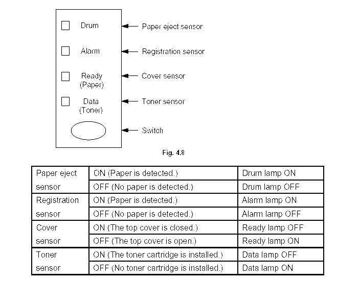

    How to check the sensors
    (1) Open the cover.
    (2) Power on the printer while pressing the panel switch.
    (3) Release the panel switch.
    (4) Press and release the panel switch.
    Results:
    *Alarm Lamp is ON = Paper feed sensor is turned ON
    *Drum Lamp is ON = Paper eject sensor is turned ON
    to jest cytat z serwisowki jak zatnie ci sie papier to bedziesz wiedzial na ktorym czujniku.. sprawdz czy kartka juz z tego czujnika spadla, porownaj z tym jak jest dobrze.... a 100% znaczy 100 % zuzycia

    This mode is used to check if the sensors in the printer are functioning correctly. In the
    process of this inspection, the lamps and the switch on the control panel are also
    checked. On entering this mode, the lamps show the status of the respective sensors as
    follows;
    Drum
    Alarm
    Ready
    (Paper)
    Data
    (Toner)
    Paper eject sensor
    Registration sensor
    Cover sensor
    Toner sensor
    Switch
    Fig. 4.8
    (1) Turn the printer power switch OFF, open the top cover, and remove the drum unit.
    (2) Turn the printer power switch ON while holding down the control panel switch. The
    Drum lamp comes ON.
    (3) Lightly press the panel switch again.
    (4) Check that the Drum (paper eject sensor) and Alarm (registration sensor)
    lamps go OFF after all the lamps have been ON.
    If the paper eject sensor is ON at this point, the Drum lamp stays ON (error).
    If the registration sensor is ON at this point, the Alarm lamp stays ON (error).
    (5) Install the drum unit.
    Check that the Data lamp goes OFF.
    (6) Lightly touch the registration sensor actuator.
    Check that the Alarm lamp comes ON.
    (7) Close the top cover.
    Check that the Ready lamp goes OFF.
    (8) Press the control panel switch.
    (9) If all the sensors are correct, the printer goes back to the Ready status. If
    any error is detected, the corresponding lamp stays ON.

    dzieki ale w tym momencie niewiele mi to pomoglo - oczywiscie pokazuje wszystko tak jak pisze - ale dalej nie wiem.
    teraz w sumie zacina sie rzadziej - moze co 20 kartek +/- ale dalej to nie satysfakcjonuje
    w momencie zaciecia obydwa sensory naraz pokazuja obecnosc na nich kartki - nie wiem czy tam cos z jakimis czasami przejscia nie ma bo switche dzialaja poprawnie z tego co widzialem

    registration sensor actuator - wygląda na to że jest to ramię czujnika rejestracji, czyli ostatniego przed bębnem (jeśli liczyć w kolejności jak biegnie ścieżka papieru)

    hmmmm..... ramie czujnika rejestracji....
    tyle ze ja tam nic takiego nie widze.
    czujniki sa 4 - jak pokazane - wejscie i wyjscie papieru, cover open i toner
    cala sciezke papieru widac jak na dloni. przed bebnem swiatloczulym jest czujnik wejscia papieru, za bebnem zgrzewajacym jest czujnik wyjscia - ale zakryty obudowa walka dociskajacego. czujnik obudowy i tonera w tym momencie odpada - wiec co ?
