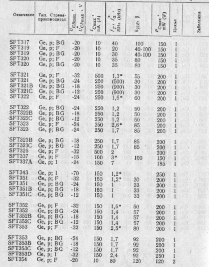

Jak w temacie. Poszukuje zamiennika tego tranzystora. Jedyne co udało się znaleźć to podstawowe parametry: SFT353
Material of transistor: Ge
Polarity: PNP
Maximum collector power dissipation (Pc), W: 0.2
Maximum collector-base voltage |Ucb|, V: 24
Maximum collector-emitter voltage |Uce|, V: 0
Maximum emitter-base voltage |Ueb|, V: 12
Maximum collector current |Ic max|, A: 0.15
Maksimalna temperatura (Tj), °C: 85
Transition frequency (ft), MHz: 1
Collector capacitance (Cc), pF: 50
Forward current transfer ratio (hFE), min: 80
Noise Figure, dB: -
Package of SFT353 transistor: TO1
