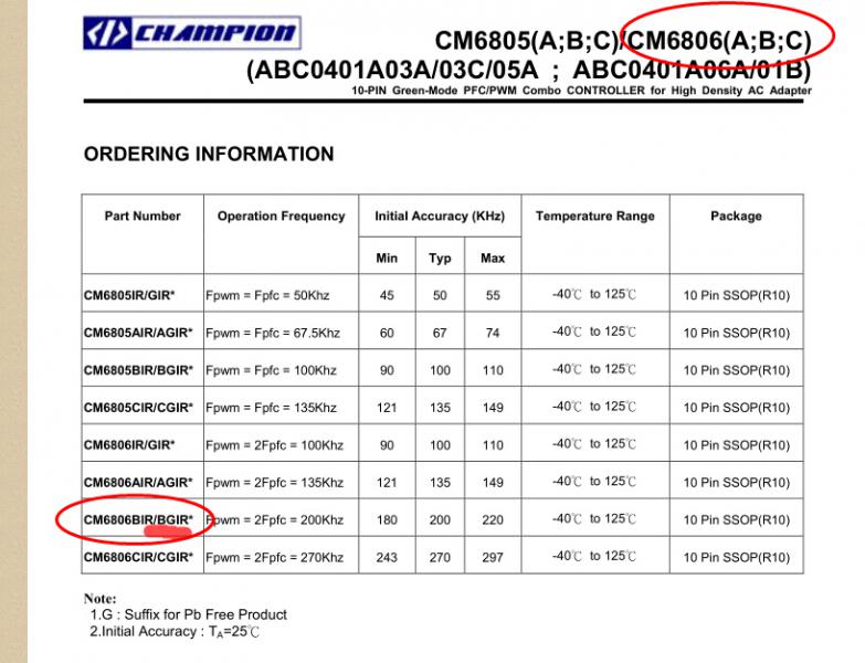

    Popatrz w załaczniki:
    -datasheet
    SOP10- (10-pin) Green-Mode PFC/PWM Combo CONTROLLER CM6806+
    The sign + is only "plus", both CM6806AG and CM6806BG are CM6806+X

    Pomiary napięć na pinach (sprawnego ATX) z CM6806+X
    ON\ Stb
    pin.1 GND GND
    pin.2 IAC INPUT-PFC IN VOLTAGE 0.7V\ 0V
    pin.3 I SENSE INPUT 0V\0V
    pin.4 VEAO VOLTAGE ERROR 1.1V\ 0V
    AMPLIFIER OUT
    pin.5 VFB INPUT-PFC OUT VOLTAGE 1,9-2.4V\0V
    pin.6 V+I INPUT-feedback PWM+LIMIT 1.3- 1,9V\0V
    pin.7 PWM FAULT INPUT=PWM SHORT,OVP 3,8V\0V
    pin.8 Vcc 10V<13-15V<18V 14.V\0V
    pin.9 PFC OUT DRIVER\PULSE 2.3V\0V
    pin.10 PWM OUT DRIVER\PULSE 2,4- 4.6V\0V
    * pin5 5 Vfb (C23 , R14=19.6k ) ... komparator Vin-OK (<2.5V)
    * przy obecnoścci imp. na PWM(10)
    1= GND
    2= 2,2- 2,7V (IAC)
    3=0.01v (Isense)
    4=0.04V
    5=2V (VFB)
    6=0.24V(V+I)
    7=3.2V fault
    8=15.75v VCC
    9=0v PFC
    10=6.95V
