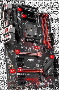

    Pomógł: 6329
    Ocena: 6840
    To z pudełka tej płyty
    BSoD page fault i system service exception na nowym PC, MSI B450, Ryzen 3600X
    To zaś spec. tego dysku Adata Link
    XPG SX8200 PCIe Gen3x4 M.2 2280
    :!: :idea:
    1. Wyjasnienie (msi-b450-gaming-plus-board-and-pcie-lanes) Link
    2. inne po wpisaniu (MSI B450 GAMING PLUS MAX M.2 Gen3 x4 PCIe NVME)/ *google
    9. Turbo M.2
    NVMe support, up to 32 Gb/s using PCI-Express Gen3 x4, Supports STORE MI
    storage support by AMD® CPU
    * 2x SATA 6Gb/s ports*
    1x M.2 slot (Key M)*
    ƒ Supports PCIe 3.0 x4 (1st, 2nd and 3rd Gen AMD
    Ryzen™, Ryzen™ with Radeon™ Vega Graphics and 2nd
    Gen AMD Ryzen™ with Radeon™ Graphics) or PCIe 3.0 x2
    (Athlon™ with Radeon™ Vega Graphics) and SATA 6Gb/s
    2242/ 2260/ 2280/ 22110 storage devices
    storage support by AMD® B450 Chipset
    y 4x SATA 6Gb/s ports
    :?: Manual czytałeś Link
