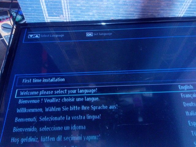

    Before leaving for work, I quickly checked the supply voltage on the matrix controller itself and it is also 12V, but by the way, with the TV turned on, I disconnected and connected the LVDS tape and something happened:
    Funai 32FDB5514/10: Brak reakcji na joystick i uruchomienie - Możliwe przyczyny
    After turning the TV off and on, the picture disappears, but by disconnected and connected the LVDS tape, it reappears, it is indeed shifted and each time the colors are slightly different, however, it is some progress.
    I wonder if it has something to do with a clock line failure like in this movie.
    Of course, in my case, the matrix is small enough, it does not have a T-CON module, so I cannot disconnect half of the matrix, but I can locate the clocks lines and try to deactivate them one by one
