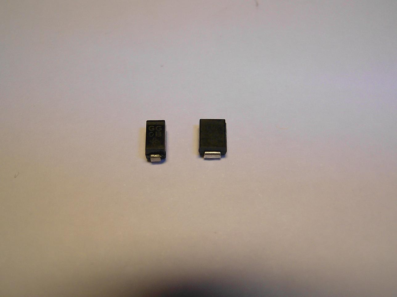

GG 3T130A Thy-SPD Vdrm=120V, Vs=160V, Ipp=50A, 40pF DO-214AA
GG BAR63-02W PIN-diode Sw, RF, 100V, 100mA, Vf<1.1V(50mA), < 0.3pF SCD-80
GG DDZ3V3A Z-diode 3.3V±10%, Izt=20mA, 500mW SOD-123
GG GF1G Si-diode Rectifier, 400V, 1A, Vf<1.1V(1A), 2s DO-214BA
GG P1300SA Thy-SPD Vdrm=120V, Vs=160V, Ipp=50A(1ms), Bidirectional DO-214AA
GG PZU8.2B Z-diode 7.76..8.64V, Zzt=105(Izt=5mA), 310mW SOD-323FL
GG T130AB-LC Thy-SPD V Of-St=120V, Vs=160V, Ipp=50A(1ms), Bidirectional DO-214AA
GG Z2SMB-9V1 Z-diode 9.1V±5%, 2W DO-214AA
Powyższe jest zależne od obudowy. Suwmiarka w rękę
LMP TPSMB24A TVS Vbr=14V, 18.1A, 600W(1ms) DO-214AA
