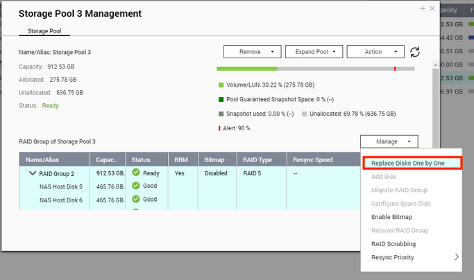

    Fragment z podręcznika użytkownika w języku angielskim:
    Expanding Capacity (Online RAID Capacity Expansion)
    Scenario
    You bought three 250GB hard drives for initial setup of a TS-509 Pro NAS and configured
    RAID 5 disk configuration with the three hard drives.
    A half year later, the data size of the department has largely increased to 1.5TB. In other
    words, the storage capacity of the NAS is running out of use. At the same time, the price of
    1TB hard drives has dropped to a large extent.
    Operation procedure
    In "Storage Manager" > "RAID Management", select the disk volume for expansion and click
    "Action" > "Expand Capacity".
    Click "Change" for the first hard drive to be replaced. Follow the instructions to proceed.
    1. When the description displays "Please remove this drive", remove the hard drive from
    the NAS. Wait for the NAS to beep twice after removing the hard drive.
    2. When the description displays "Please insert the new drive", plug in the new hard drive to
    the drive slot.
    3. After plugging in the hard drive, wait for the NAS to beep. The system will start
    rebuilding.
    4. After rebuilding has completed, repeat the steps above to replace other hard drives.
    5. After changing the hard drives and disk rebuilding has completed, click "Expand
    Capacity" to execute RAID capacity expansion.
    6. Click "OK" to proceed.
    7. The NAS beeps and starts to expand the capacity.
    Tip: After replacing the hard drive, the description field shows "You can replace this drive". This
    means you can replace the hard drive to a larger one or skip this step if the hard drives have been
    replaced already.
    Caution: When the hard drive synchronization is in process, Do NOT turn off the NAS or plug
    in or unplug the hard disk drives.
    The process may take from hours to tens of hours to finish depending on the drive size. Do
    NOT turn off the NAS during this process.
    After RAID capacity expansion has finished, the new capacity is shown and the status is
    "Ready". You can start to use the NAS. (In the example you have 1.8TB logical volume.)
    Warto czytać instrukcje ze zrozumieniem.

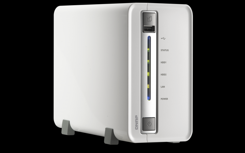

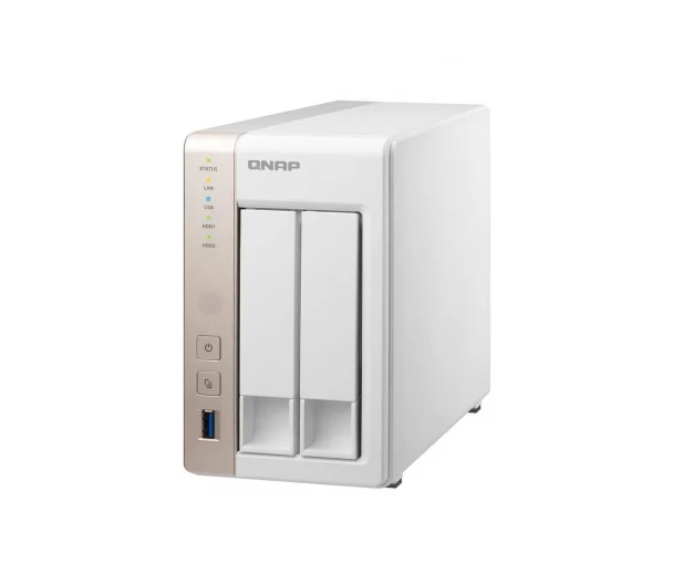

    Dzięki za odpowiedź. Niestety, ale w temacie napisałem informację, aby uniknąć tego typu odpowiedzi.
    Twoje rozwiązanie faktycznie zda egzamin przy QNAP'ie, który wygląda w ten sposób:
    Wymiana dysków w QNAP TS-212 z 2TB na 4TB w RAID 1 - Jak bezpiecznie odłączyć dysk?
    Natomiast nasz QNAP wygląda w ten sposób.

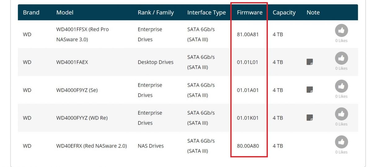

    @ITSSYSTEM
    jprzedworski napisał:
    Tu jest lista zgodnych dysków:

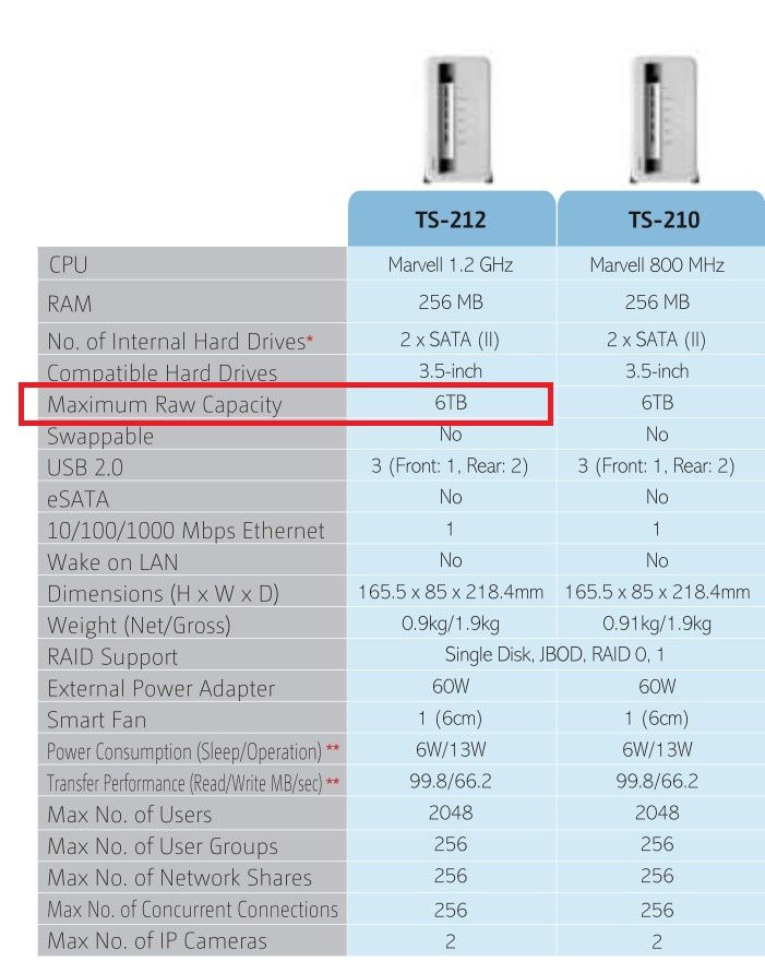

    Według tego, 4TB obsługuje, ale dysk musi mieć odpowiednie firmware (czerwona ramka), Autor ma dyski WD, więc takie wywołałem do tabelki:
    Proszę spojrzeć również na screena co wstawiam (czerwona ramka).
    Bo wychodzi, że maksymalna łączna pojemność dysków to 6TB:
  • #19 20049800
    ITSSYSTEM
    Poziom 5  
    Posty: 12
    Czyli jak? Wychodzi na to, że 4TB w RAID 1 to dla niego za dużo?

    Po pierwsze wychodzi, że dyski muszą mieć odpowiednie oprogramowanie.
    Po drugie wychodzi, że łączna pojemność dysków będzie przekroczona.
    Nie jest żadną tajemnicą, że bardzo często to co pisze sam producent, nie zgadza się z tym co jest w rzeczywistości - trudno mi powiedzieć jak jest tutaj.
