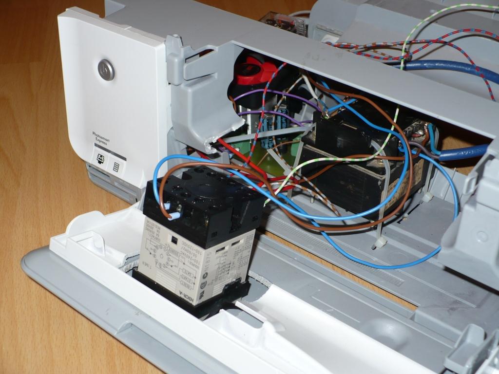

    LED naświetlarka do PCB.
    Kryt zo starej tlaciarne HP Photosmart C3180
    Transformator zo stareho TV
    LED: 6x1W UV
    Casovac: Omron H3CR-A
    Czas potrzebny do oświetlenia 5~6 minut.

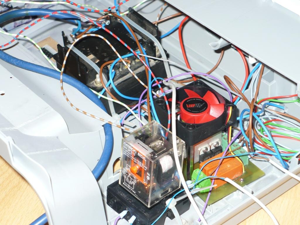

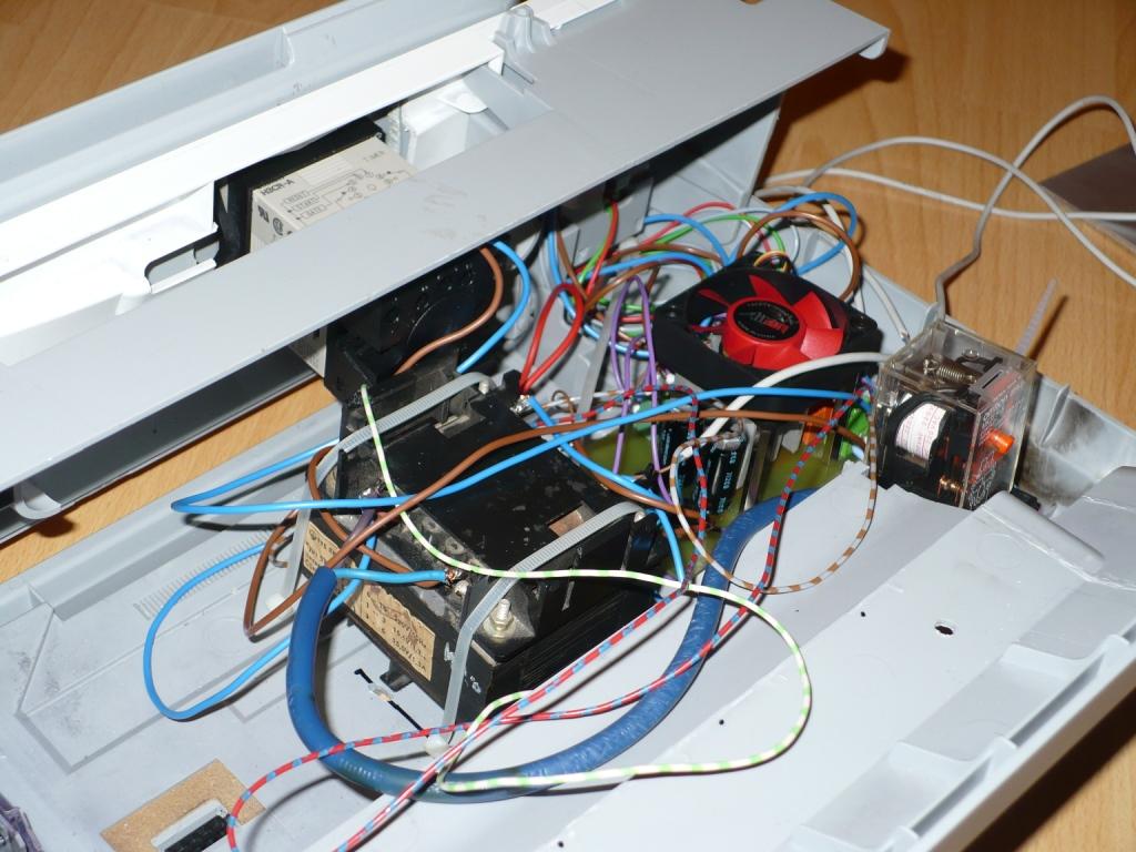

    My English is also not good. For voltage regulators, I had to put coolers. Just thicker aluminum. Source is very simple. Voltage is over 12V L7812CV and subsequently through LF33CV to 3.3 V.

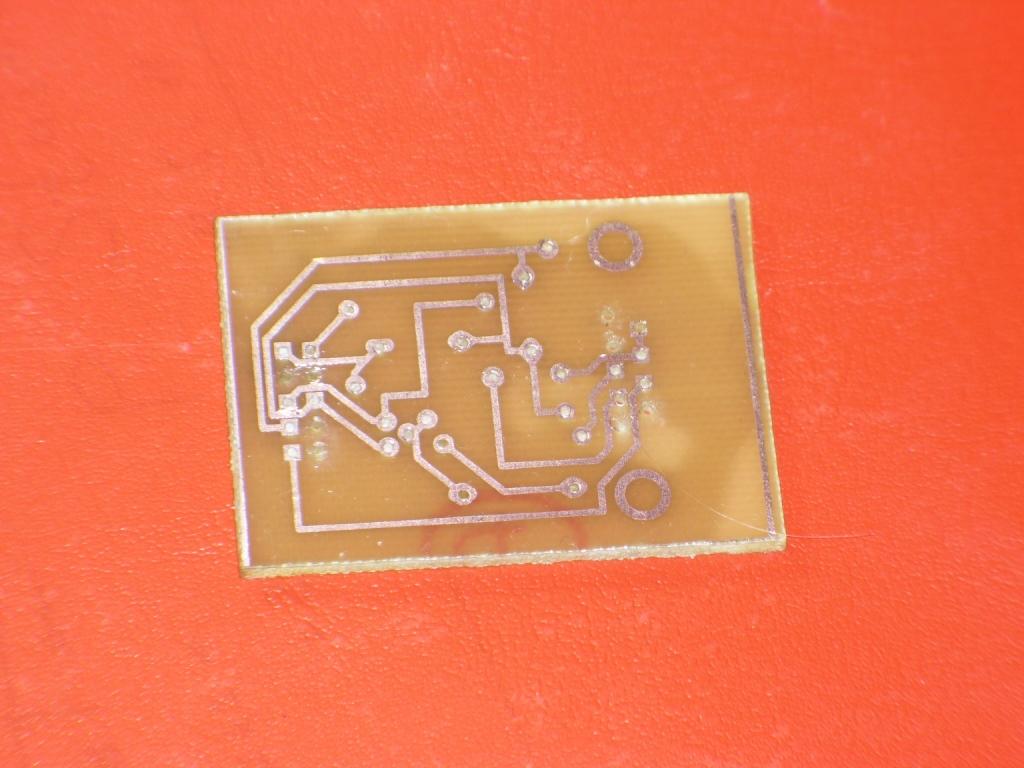

    My first test board:

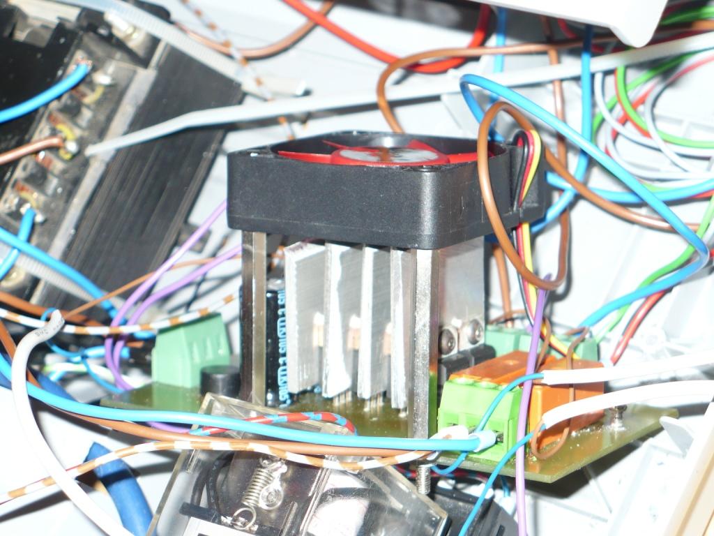

    Added simple heatsink:

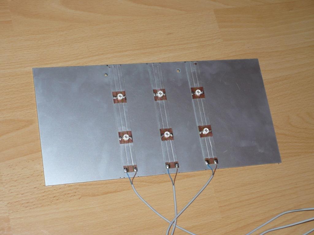

    UV LED board:
    OK, in the new pictures I see that you actually have a fan AND some kind of heat sinks. That makes more sense.

    reddwarf napisał:
    Angle of LED is great (140°), the lighting should be evenly.
    Angle 140° you say, but how is it defined? I'm pretty sure that light intensity among this angle is not even. Check the datasheet (if you have the LED's part number) and you should find there an angular intensity characteristic. I would expect the light to be significantly uneven in your design, however, it's probably possible to find a "sweet spot" for exposure time to make it work for most PCBs. But I would consider adding there some kind of diffuser anyway... assuming it's easy to find appropriate material for diffusing UV in that range. Or more LEDs of course, but that will drive up the cost.
    The last picture: do you have the LEDs in that pairs connected in parallel? In the picture it looks like you do, and it's not a good idea to do it this way.

    Yes, I have LED pairs connected in parallel. Why is it not good? I think it's better than serial. Each stabilizer are strong enough to be able to power the 2 LEDs.

    I would not buy an "unknown" LED like that from eBay (no manufacturer and part number info = unknown) unless the price is low enough in compare to "known" LEDs that it makes it worth to take the risk. I assume that's what happened in your case. Anyway, if there's no technical specification available for those LEDs you can't do more that just try and see what happens. But I think I don't really have to mention that :)
    Parallel connection is bad because voltage drop of LEDs is always slightly different from part to part. It means that supplied current will never be divided perfectly even between LEDs connected in parallel, and you don't have any control of what that current distribution will happen to be. Technically, when you connect any components like that in parallel, you should add small resistors in series with each component to help distribute current evenly. In case of LEDs connection in series is almost always better and more electrically efficient and the only problem might be higher voltage needed to power LEDs connected in series. In your case, you have 12V on board there so powering two UV LEDs in series should not be a problem I guess (I don't know what's the voltage drop though, but this is easy to measure). My rule of thumb is NEVER connect LEDs in parallel and probably majority of guys here will agree.
