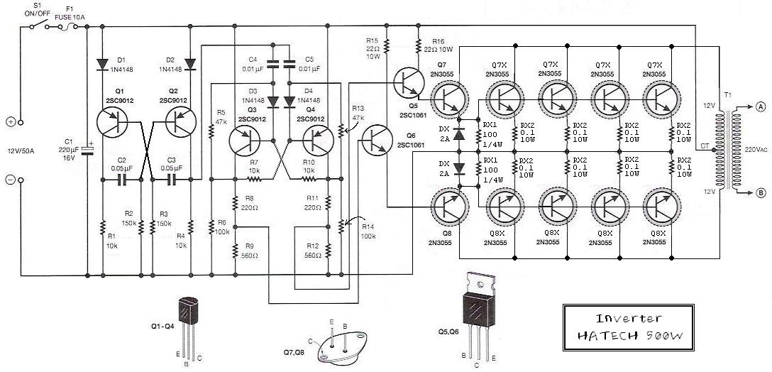

    i like this design

    DS
    Posty: 152
    Pomógł: 8
    Ocena: 26
    This is not welding power source.
