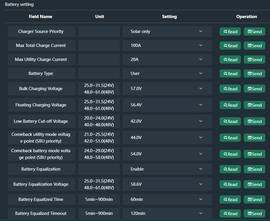

    Po dłuższym podsłuchiwaniu udało mi sie dopasować część rejestrów konfiguracyjnych.
    Oprócz tego natknąłem się na jakiś opis rejestrów inwertera PowMr na tej stronie: https://github.com/odya/esphome-powmr-hybrid-inverter/blob/main/docs/registers-map.md
    Wklejam poniżej moje odkrywki zrobione na podstawie dessmonitor'a:

    Bulk Charging Voltage
    25.0~31.5(24V) 48.0~61.0(48V)
    05 03 13 A3 00 01 71 28
     Set 56.3V: 05 06 13 A3 02 33 3D 9D
    Floating Charging Voltage
    05 03 13 A4 00 01 C0 E9
     Set 54.6V: 05 06 13 A4 02 22 4C 50
    Low Battery Cut-off Voltage
    20.0~24.0(24V) 40.0~48.0(48V)
    05 03 13 A5 00 01 91 29
     Set 42.0V: 05 06 13 A5 01 A4 9C C2
    Comeback utility mode voltage point (SBU priority)
    21.0~25.5(24V) 42.0~51.0(48V)
    05 03 13 A1 00 01 D0 E8
     Set 43.0V: 05 06 13 A1 01 AE 5D 04
    Comeback battery mode voltage point (SBU priority)
    24.0~29.0(24V) 48.0~58.0(48V)
    05 03 13 A2 00 01 20 E8
     Set 52.0V: 05 06 13 A2 02 08 2D 8E
    Battery Equalization
    05 03 13 93 00 01 71 27
     Set:
     - prohibited: 05 06 13 93 00 00 7C E7
     - enabled: 05 06 13 93 00 01 BD 27
    Battery Equalization Voltage
    05 03 13 A6 00 01 61 29
     set 58.0V:  05 06 13 A6 02 44 6D BA
    Battery Equalized Time
    5min~900min
    05 03 13 A7 00 01 30 E9
     set 60min: 05 06 13 A7 00 3C 3D 38
    Battery Equalized Timeout
    5min~900min
    05 03 13 A8 00 01 00 EA
     set 120min: 05 06 13 A8 00 78 0D 08

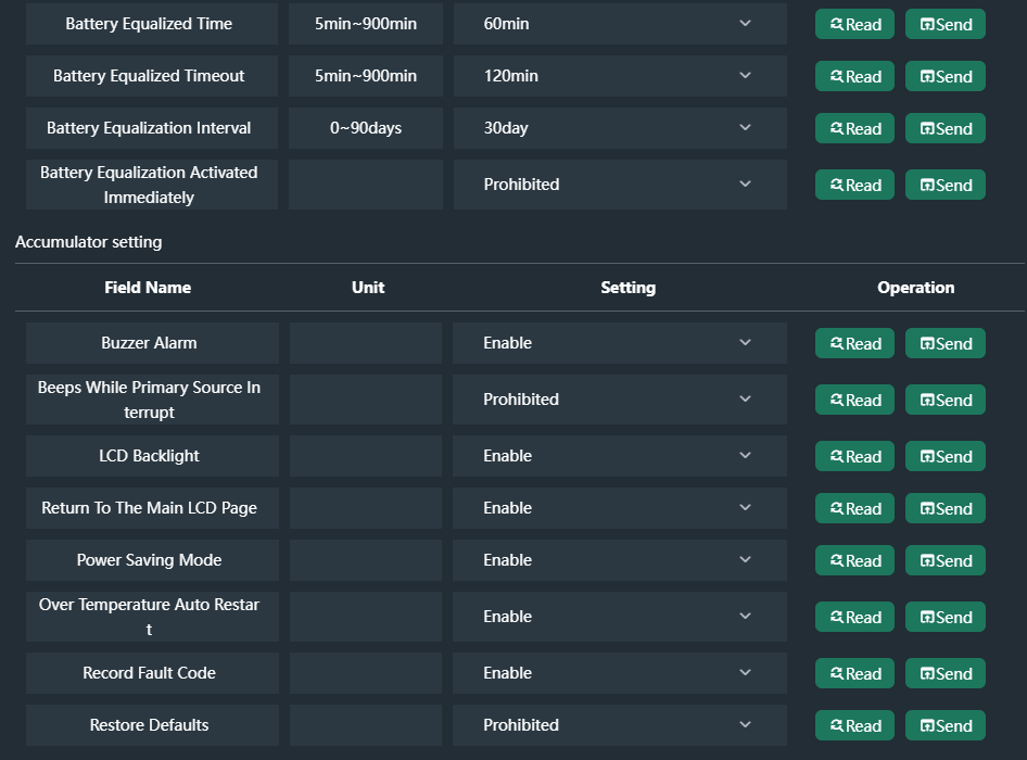

    Battery Equalization Interval
    0~90days
    05 03 13 A9 00 01 51 2A
      set 30days: 05 06 13 A9 00 1E DC E2
    Battery Equalization Activated Immediately
    05 03 13 94 00 01 C0 E6
     set:
     - prohibited: 05 06 13 94 00 00 CD 26
     - enabled: 05 06 13 94 00 01 0C E6
    Accumulator setting
    Buzzer Alarm
    05 03 13 8A 00 01 A0 E0
     set:
     - prohibited: 05 06 13 8A 00 00 AD 20
     - enabled: 05 06 13 8A 00 01 6C E0
    Beeps While Primary Source Interrupt
    05 03 13 8F 00 01 B0 E1
     set:
     - prohibited:  05 06 13 8F 00 00 BD 21
     - enabled: 05 06 13 8F 00 01 7C E1
    LCD Backlight
    05 03 13 8C 00 01 40 E1
     set:
      off: 05 06 13 8C 00 00 4D 21
      on: 05 06 13 8C 00 01 8C E1
    Return To The Main LCD Page
    05 03 13 90 00 01 81 27
      set:
       off: 05 06 13 90 00 00 8C E7
       on: 05 06 13 90 00 01 4D 27
    Power Saving Mode
    05 03 13 8B 00 01 F1 20
     set:
      - off: 05 06 13 8B 00 00 FC E0
      - on: 05 06 13 8B 00 01 3D 20
      resp for enabled: 05 03 02 00 01 88 44
    Over Temperature Auto Restart
    05 03 13 8E 00 01 E1 21
     set:
      off: 05 06 13 8E 00 00 EC E1
      on: 05 06 13 8E 00 01 2D 21
    Record Fault Code
    05 03 13 92 00 01 20 E7
     set:
       - off: 05 06 13 92 00 00 2D 27
       - on: 05 06 13 92 00 01 EC E7
    Restore Defaults
    05 03 13 98 00 01 00 E5
     set:
      - off: 05 06 13 98 00 00 0D 25
      - on: 05 06 13 98 00 01 CC E5
